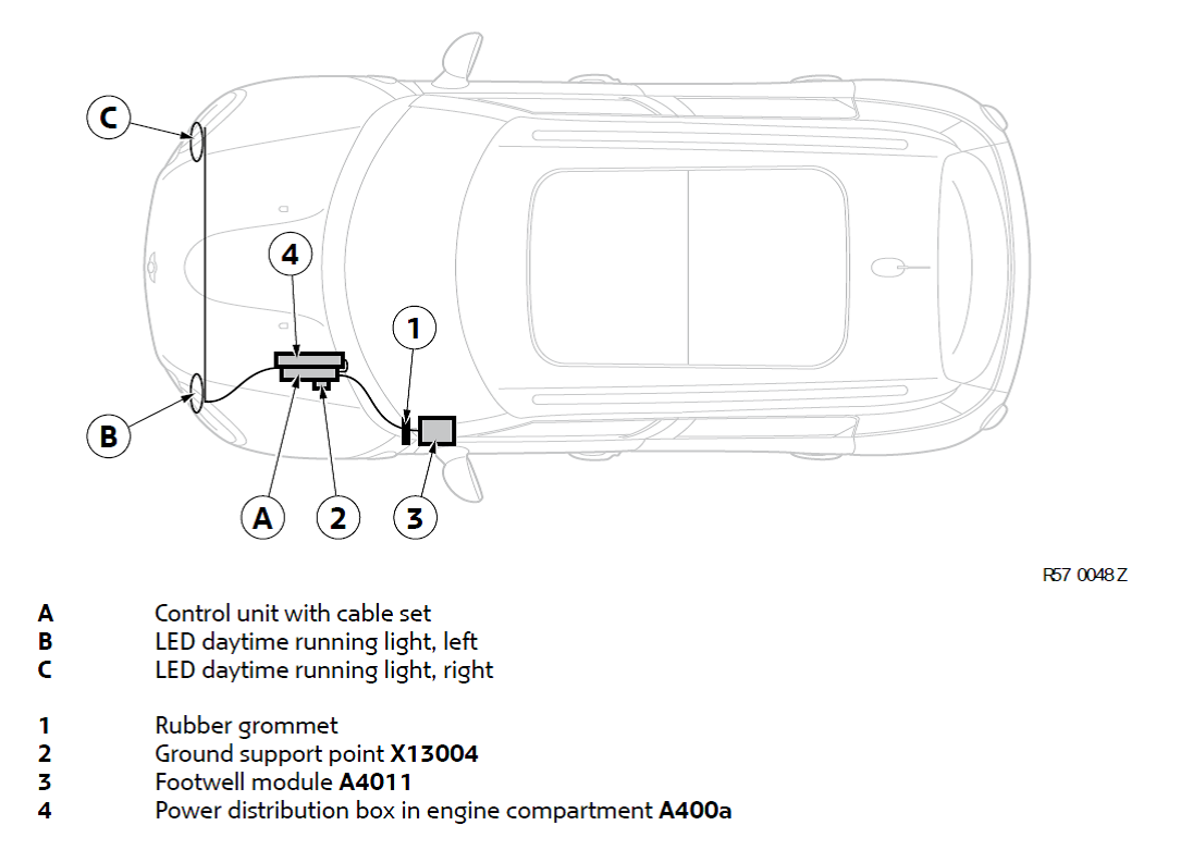

The pass-thru that MINI recommends for installing their LED Daytime Running Lights. There is a rubber grommet covered by a hard plastic cap. The rubber grommet has two tabs sticking out that you can cut off showing a passthru to the inside of the car. The following is from those instructions.
Also, the following video at time of 4:36 shows the grommet and the plastic cover.

Originally Posted by TJANK
The pass-thru that MINI recommends for installing their LED Daytime Running Lights. There is a rubber grommet covered by a hard plastic cap. The rubber grommet has two tabs sticking out that you can cut off showing a passthru to the inside of the car. The following is from those instructions. Also, the following video at time of 4:36 shows the grommet and the plastic cover. Video Link: https://youtu.be/f9LGYVBU3Sg?t=279
Thank you worked perfectly!

+1 TJank hit it right on. Should fit a pretty nice size gauge wire.
