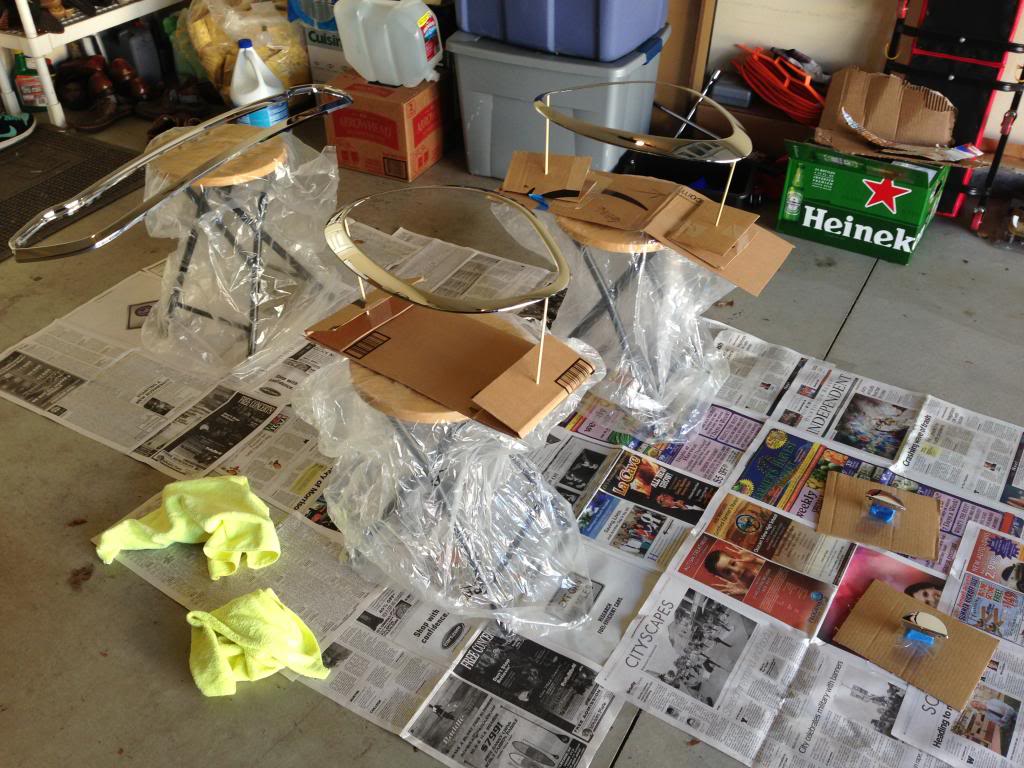

Chrome pieces: Having used paint, Beltline (Sucks), 3m scotchprint 1080, and plastidip, I found the last two to be the easiest and best.
I used 3m vinyl on my trim rings and the remaining chrome pieces I used black pastidip with glossifier top coat. Door handles are tough. Started with plasti dip and found the texture funny, vinyl was a pain in the butt, then just bought on ebay carbon fiber door handles, which had to be modded to fit for comfort access button.
The top pic shows the headlight trim in gloss black vinyl and a basic plasti dip coated headlight washer cover. There is a difference. The rear pic shows it with glossifier on the emblem and trim rings with vinyl wrap. Not a great match, but pretty dang good. Will try to upload close ups today.

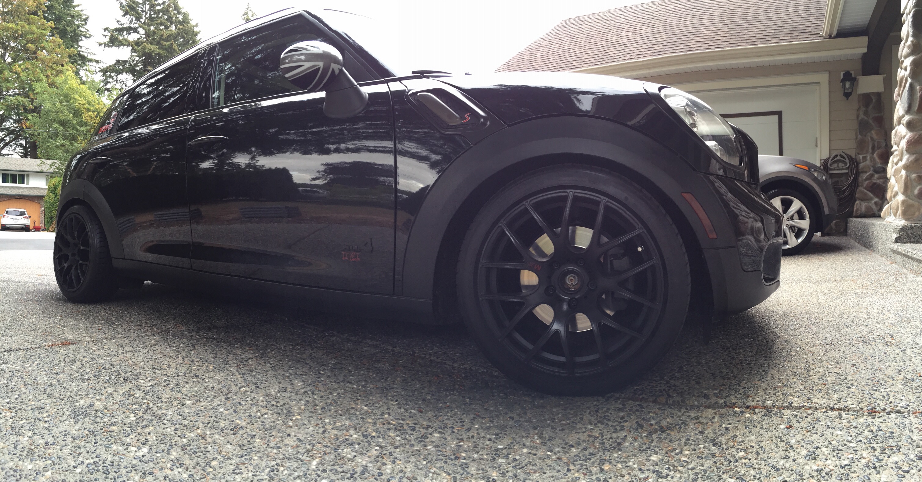

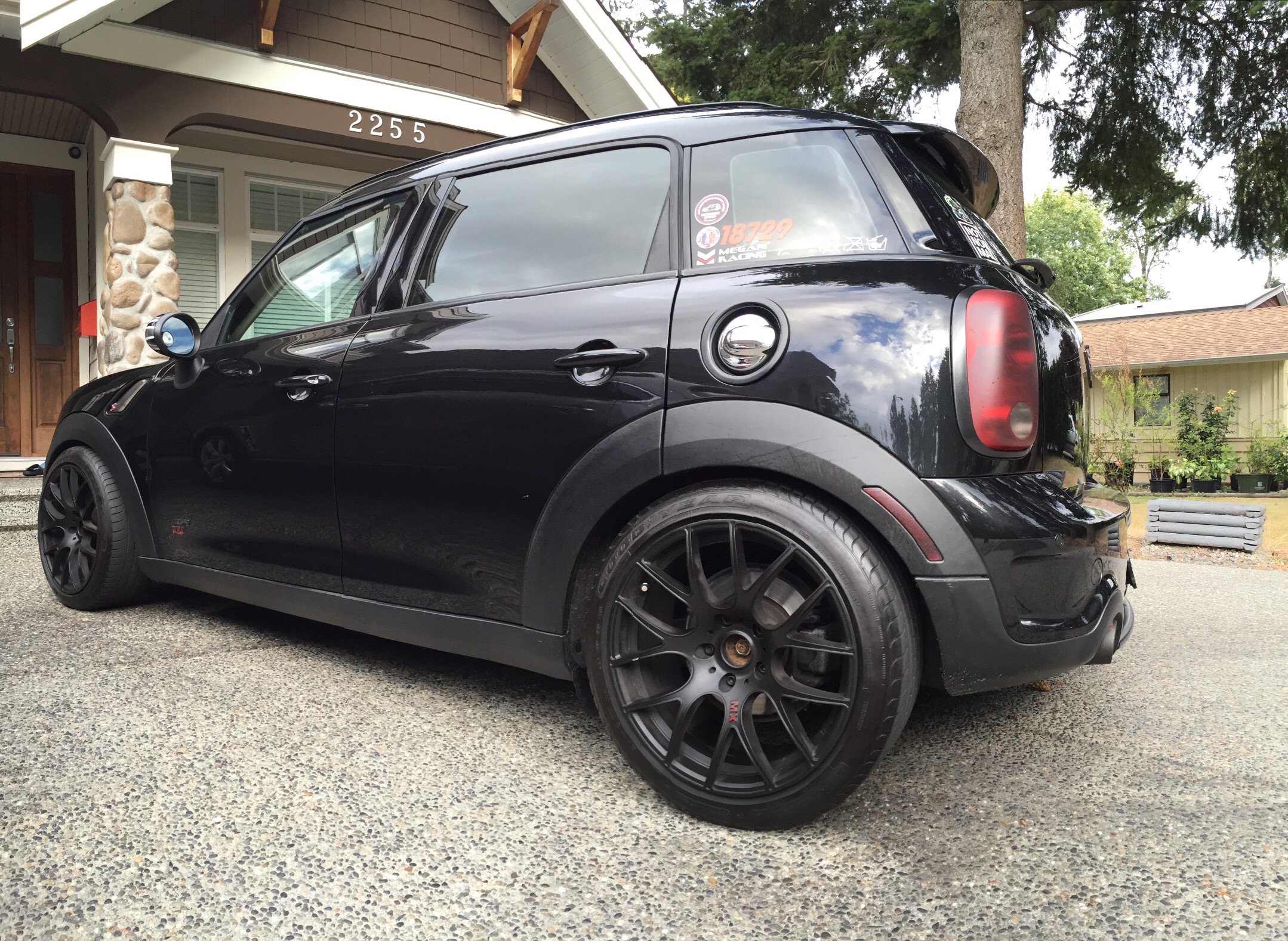

I dipped the emblems, front and rear light trims, wrapped the roof rails (not very good job, first timer will rewrap them again in spring time) and installed skin on the door handles. Taped the belt lines with black 3M wire tape. Not easy but safe $$$$ for all. I don't really like chrome and the last part will be the gas cap to be blackened.
Attached Thumbnails Tint and Vinyl Wrap blackout chrome prices or easy DIYs?-img_3442.jpg   Tint and Vinyl Wrap blackout chrome prices or easy DIYs?-img_3449.jpg
