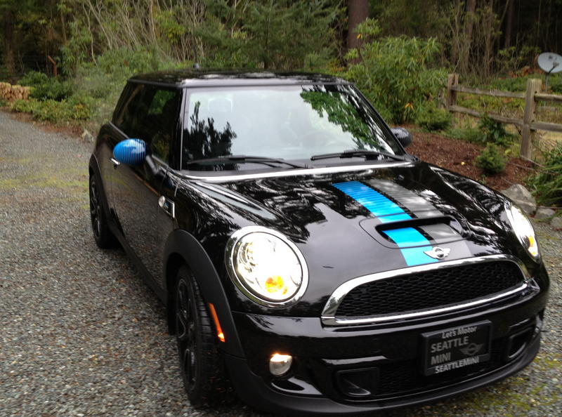

Just picked up our "little miss" 2 weeks ago and we were told nothing over 6500 for 1200 miles and no cruise control. We are trying hard My husband and I are different drivers so I know that going different speeds is no problem.
This is so much fun! Jamie & Doug

Very cool car! Saw a similar one at Mini of STL the other day - LOVE the stripe contrast.
Certainly nothing over 6500 for the first 500-1000 - that's 100% true for the piston seals to seat, etc.

Thanks!! My husband says that she is "neat but not gaudy"
