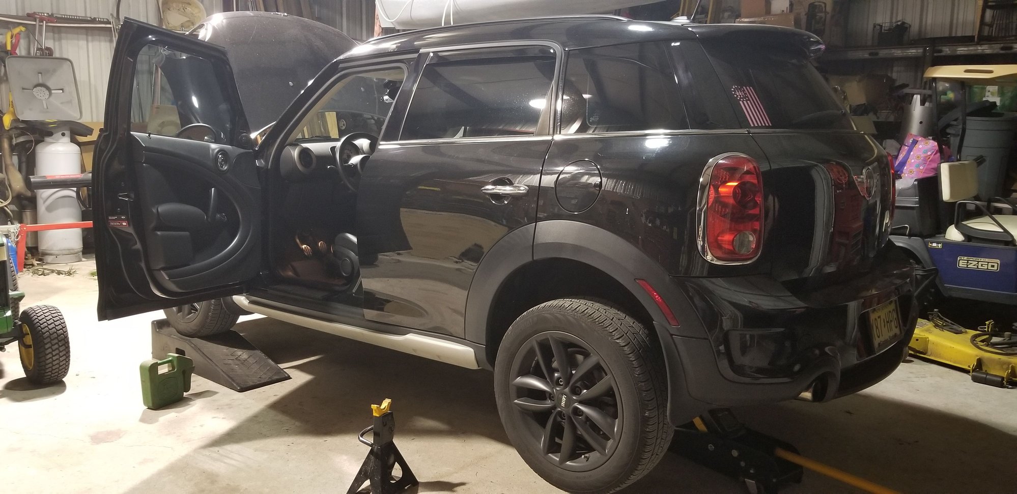

Set the height to something more functional. Had to raise the front a little to compensate for the 3" exhaust. I'll need to get the exhaust tightened up in there, then I'll lower the car another .5 to 1 inch again.
Also fixed the extreme camber in the rear, it was set at -3.2 to compensate for the rubbing against the metal frame by the rear door. I had an awesome wheel shop cut it all off and weld it back together. No more rubbing there. I also trimmed the inside fenders, both the metal bracket and plastic. That opened up about 1" of space, which allowed me to set the rear camber at -2 degree with zero rubbing. Probably could go to -1.5, but I like the aggressive look. I also set the front camber to -2.2 degree. With the 25mm RSB the car feels it really balancing it all out.
Anyways, here's the updated pic with the new height and trimming, but before the new alignment. I'll take some better ones once the rain stops.

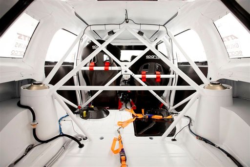

Nice and well done.
Just talked to someone who helped produce the suspension to that WRC MINI. It was all custom and had custom front knuckles/carriers. Cant tell you who just yet.
That suspension is pretty awesome and tough setup, only seen pictures though. That rear MacPherson setup is really cool... I want it.

Well its Ohlins, i can tell you now as we carry there line. It was a custom motorsport R60 design, they dont have a direct fit R60/R61 kit yet.
Eye spy...
I'd be happy with the rad, IC and intake manifold setup.

That be it! Prodrive did a lot of the other items.

Eye spy...
I want that hood.
Holy Crap! Look at those top mounts for the front shocks and why does that engine bay look like it has so much room.

The whole front end is tubular...so lots of room. Its safe, but not "production-car-crumple-zone-safe"

I want that hood.
ECU is in the passenger footwell, Rad/IC is moved more forward on the chassis, wire harness is out of the way, no firewall plastic, engine is slightly titled away from the front and so much more...

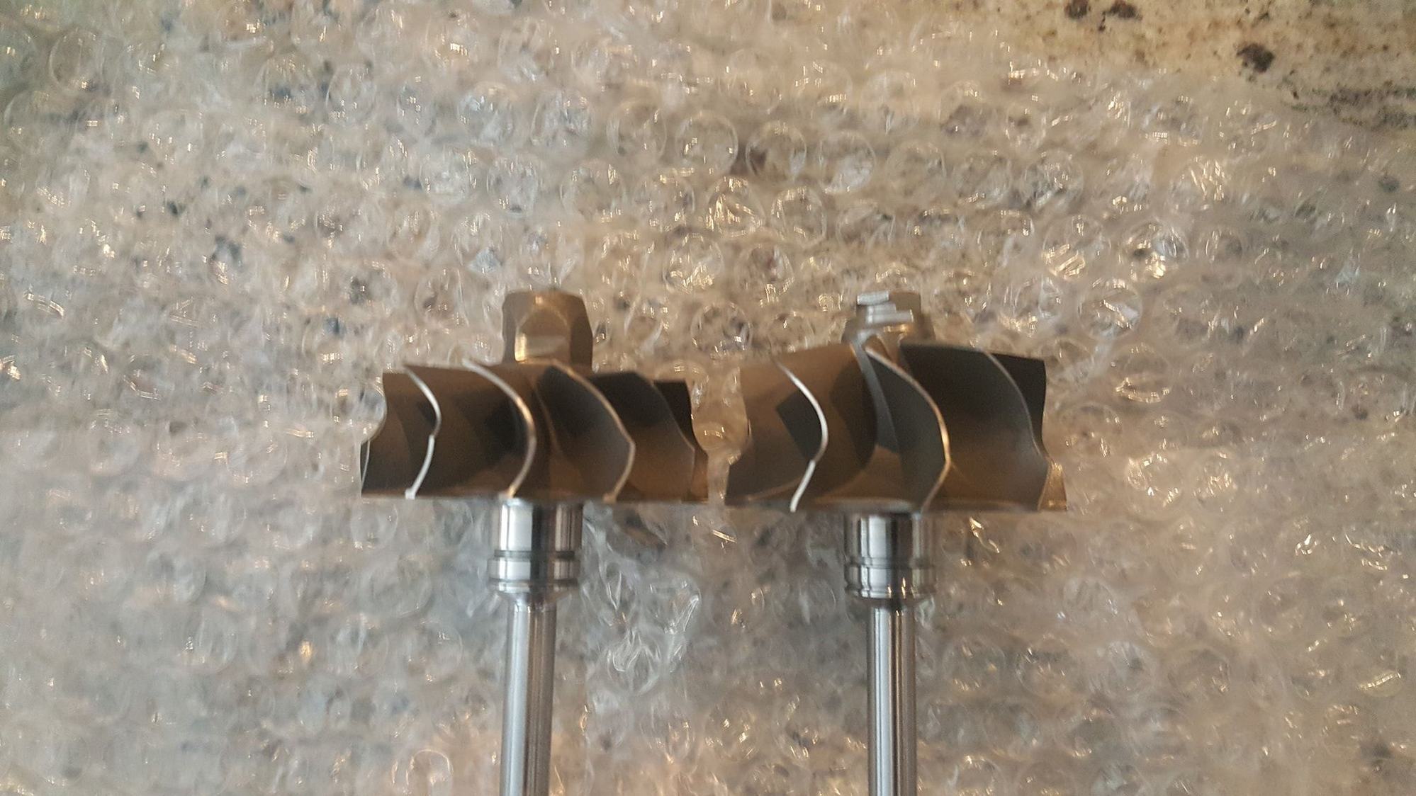

Getting closer. Switching out the 12 blade for the tall 9 blade turbine for the 50mm turbo build. Had some custom parts that arrived for the cold side aluminum IC piping I'll be making.
Vibrant Hi-flow cat also showed up this past Friday.
Yep that's one of the old WRC cars. With the Ohlins one-off suspension.
