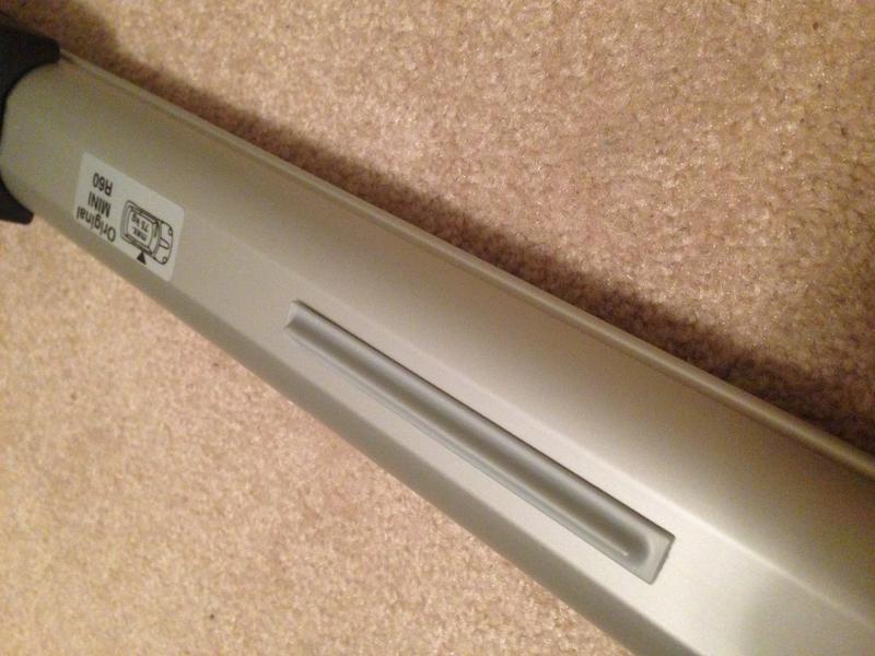

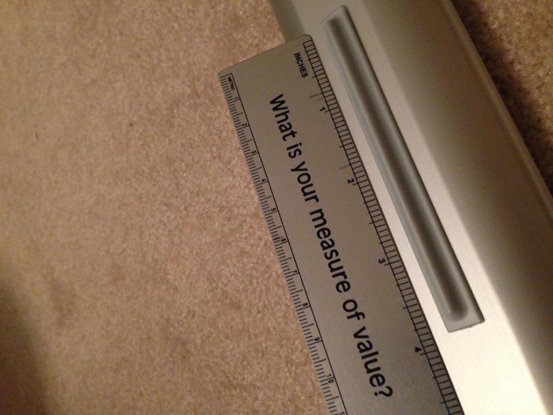

Does anyone have a lead on where I could buy replacement pieces or get measurements of the pieces as described above. My rack is missing them.
Here is a photo showing one of three plastic sound dampening pieces ONLY affixed to the front underside of the rail. Size is apprx 4 inches. The three were already affixed when I received them.
