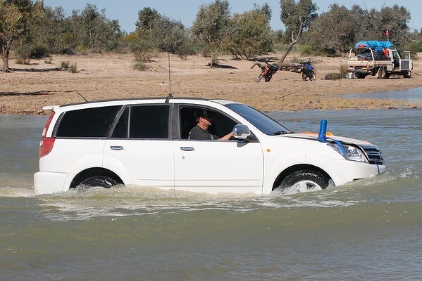

Originally Posted by DR61
Yes; the engine intake is about 28-29" above road level. If you go through standing water greater than 12" there is a good chance that the forward speed of the car will cause water in the front to surge up to twice that level, which could hydro-lock your engine. If you drive through standing water, go as slowly as possible to avoid water surging...
The Age newspaper in Australia, in their Drive section, shows how they tested the Great Wall SUV from China, which included a water crossing. Note how they improvised protection from water getting in the intake.
Attached Thumbnails Water crossing in a Countryman S ALL4...how deep can it go? :)-greatwallwatercrossing.jpg
