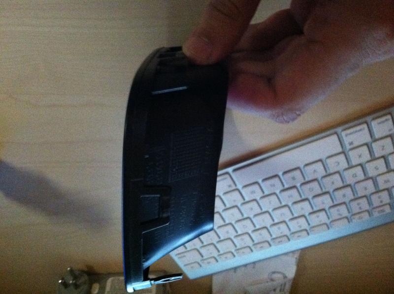

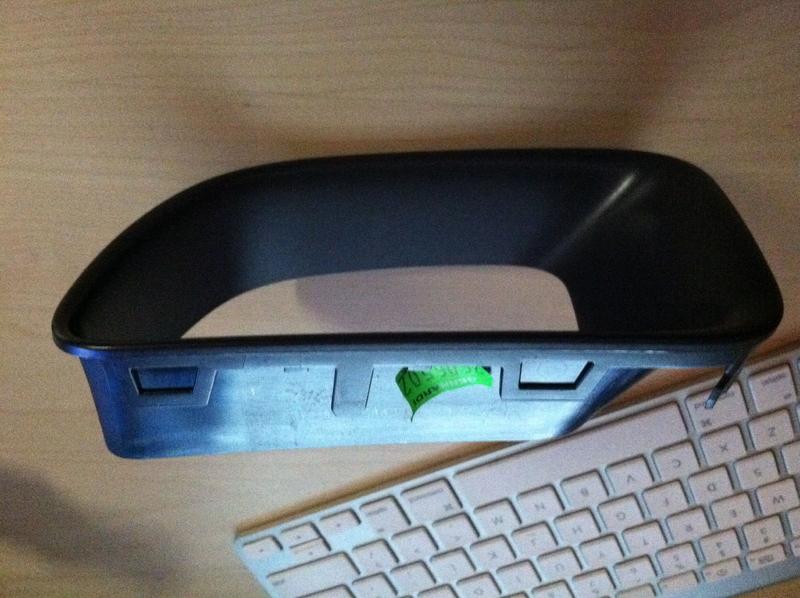

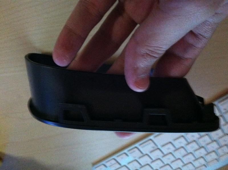

Promise it's not too hard
Here are some photos of the clips on one of the ducts I removed:
EDIT:
Don't know why all my photos upload upside down the first time. I'm not going to correct it since you can still see the clips.
Attached Thumbnails Countryman S Red Brake Ducts & Mirror Caps-top.jpg   Countryman S Red Brake Ducts & Mirror Caps-left.jpg   Countryman S Red Brake Ducts & Mirror Caps-bottom.jpg

Excellent! This looks like something I can do.
I am assuming that the brake ducts tabs (clips) go over the mechanism that catches them? Or does the duct fit inside a "receiver" part? I'm sure all this will be much clearer once I take delivery and have a chance to nose around a bit.
