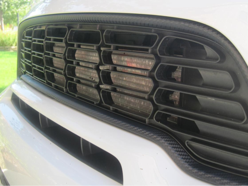

I wedged tooth picks in each clip and it then popped off. I started with a small screwdriver of course.
