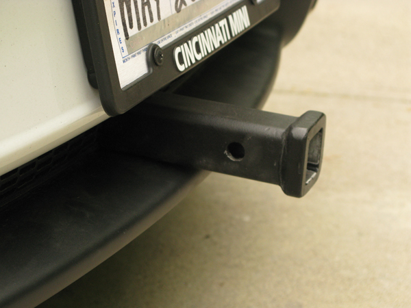

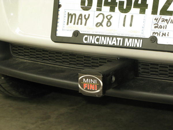

I drove to Columbus, Oh this morning, and the guys at MINIFINI installed a one and quarter inch hitch on my Countryman for bike transport. Being an avid biker, I opted for an extension that extends a few inches out from the grill and makes mounting the rack a 30 second procedure in clear view. They did a great job. Cost was ~$688.00. Pefect for my Yakima rack or any future rack I may want.

Hitch breakdown
The price for the MINIFINI hitch hardware is around $275. They ship all over. The hitch, as designed, has the receiver flush with plastic grill, requiring you to fish around somewhat blindly under the car, trying to align the holes on your rack with those of the hitch. To avoid this hassle I had them custom build a small extension that sticks out a bit but not enough to significantly impact the beauty of the car (see posted photos). This cost about $75. The rest is labor cost which is not insignificant, as the entire bumper assembly has to be removed, including a bunch of plastic rivets that have to be removed and replaced. I would not want to tackle this process myself, but one of the posters has done it successfully (congrats!!). In the end, it's not cheap but you have a functional hitch that can accept any 1 1/4in bike rack (or other load) , including a 4 bike rack. You have paid somewhat less than you would for the factory designed MINI Cooper rack, and the latter has only a thick band of plastic that secures your bike to the rack, is more of a pain in the *** to install, and can only hold 2 bikes. My Yakima rack secures the bike to the rack with a steel cord. I don't know how much your bike is worth, but mine is worth much more than the rack, hitch and assembly combined, so security is a significant issue for me .

hitch extension
Russell Sr. at MINIFINI said he could find an extension the right length in his books to order, so he fabricated it. You might call them and ask, and call a few local places like Autozone. The extension makes it very convenient to attach your hitch.

Posts: 17
1/4 inch extension appears to be 10 inches length with holes 2 inches from either end.
