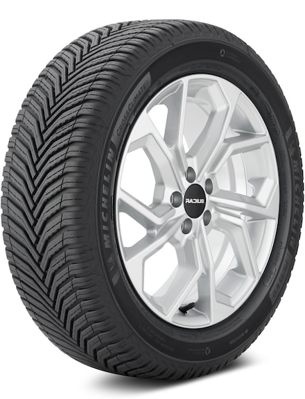

What model and size tire did you go with? (Cross Climate2's??)

As for the tires, they are Michelin X radial competition gravel tires in hard compound 😜 195/65r15. It's AZ and you can just about register a cardboard box with lights. We'll see how they go. My friend used to run a WRX pro car team and these were nearly free.
