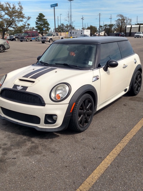

Thanks for the welcome. Here is a picture of the new wife mobile.

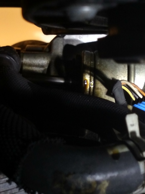

Also if anyone can tell me why I'm finding oil on the wastegate, i'd appreciate it.

Where is the oil originating from?

Looks like its dripping off the wastegate.

Check the crush washers on the turbo oil feed line. Is oil running down the cartridge onto the wastegate?
Oh, and congrats on the new ride--and don't forget that with R56s, you have to change the oil early and often. Don't be shy to do it ever 4-5k miles.

How's it going, been almost a year with the mini. So the oil near the turbo was the oil return line. Replaced that and then there was a slew of oil leaks that had to be fixed. Most recent was the front crank seal which the dealership had to replace 3 times because they were installed wrong twice.

The oil line is a common leak, but glad you got that and your other oil leaks fixed. Also, check out what M7 intakes are available for your R56 here.
