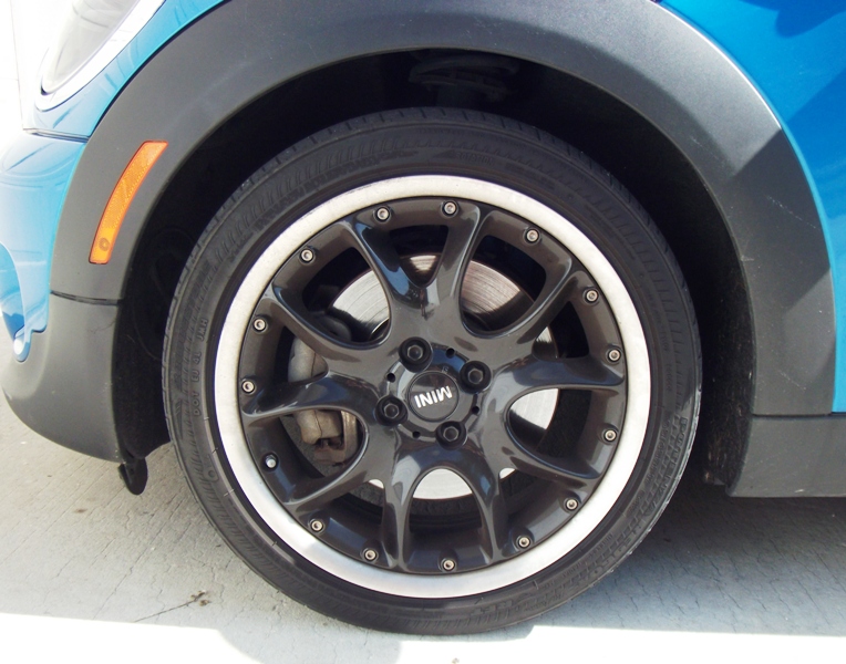

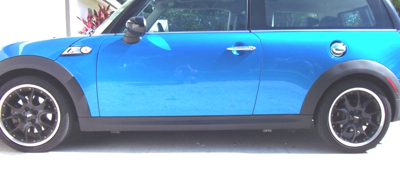

I have a 2011 Clubman S with Bridgestone Potenza RE960AS Pole Position tires in 205/45/17 Run Flats.

I can tell you my 215/45/17 rub a tad in the front fender on the carpet like stuff, nit much and maybe when loaded down only as it's not going to rub through. My car is stock height.
My wheels are 7.5" wide, if they were 7.0" I would have gone 205 but hate the stretched tire look, so I went to 215.

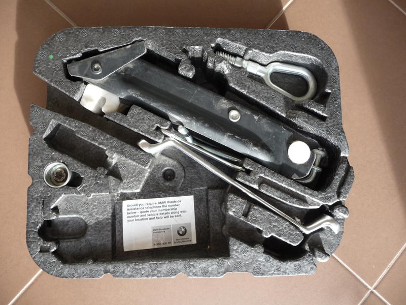

Does anyone know if there's another spare tire that will fit on the MINI? Is this a proprietary bolt pattern? All the MINI spares I've found are expensive. If there was something else that would fit I just go to the junk yard and get one.

If you need a spare tire to pack into your boot with a cover to keep it all clean,
Tirerack.com sells steel 15x6" wheels cheap at $58 each that are used for winter tires.
If you have a base cooper Clubman this wheel should fit and you can mount any OEM sized tire like 175/65-15 that can be used as a spare, not even a compact spare but only marginally larger.

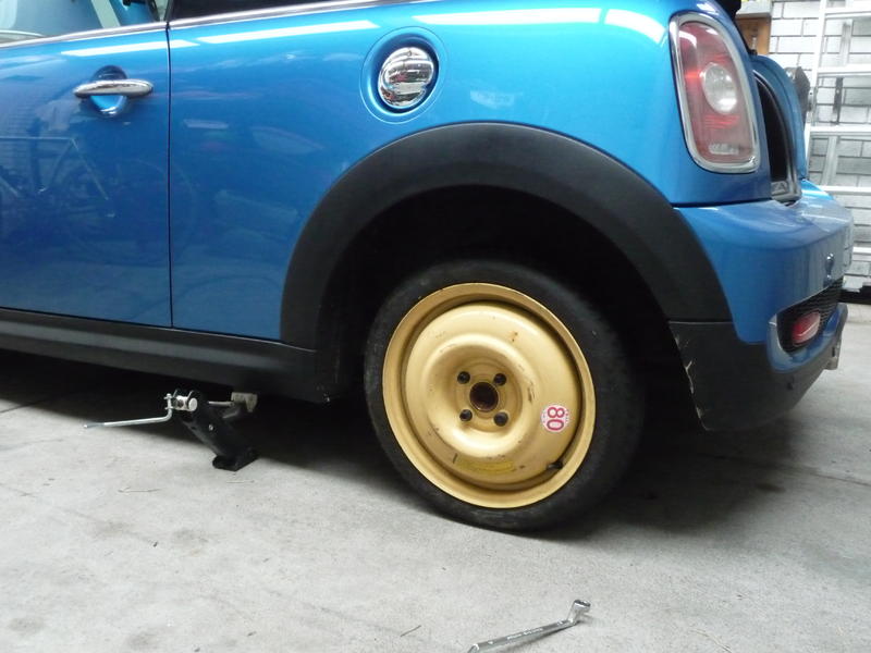

Honda Jazz/Civic 15" but will not clear S front brake callipers so if you get a flat on the front it requires two tyre changes to move a good tyre from the back to the front and put the space saver on the back.
Recently changed from RFT to standard tyres went to the wrecker and picked up the above spare and a jack which fits the polystyrene cut out under the cargo cover with a slight trim. Total cost $38

A taller tire diameter means that if you do ever lower the suspension there will be less clearance and more risk for rubbing.
A wider than OEM wheel like 17x8" will also give you less clearance and more need to use negative camber to make things fit which can wear the inner treads faster.
Some tires in this size either cost a little more or weigh a little more but it's not much or even the reverse so check both sizes.
Overall using Stock suspension and wheels, 215/45-17 is a very good size for the MINI.
A good example of a tire that would work is-
General Altimax HP Grand Touring all season tire, 440 treadwear, $67 each closeout.
So wheel for $58 and tire for $67, tirerack does the mounting and then ships it to you. Put it in a bag and place in boot. You don't really need to bother with TPMS. Allow wheels start from about $85 each,

Thank you so much for the wealth of info. I'm learning alot of this for the first time and your input has been valuable. I've done alot of research in the last two days on the Ventus Noble, I think I'm going to go with that one. Handling is slightly more important to me than comfort. My nearly bald Potenzas beat the crap out of me and the car, I feel like anything would be an improvement at this point. I'm going to get a spare - I feel like it's a good trade off for all the downsides of run flats.
I think this is the route I'm going to take. I like everything I've read ad heard about these tires. Just looking for a spare tire now - went to 3 junkyards today and no one had a Chevy Cobalt for the spare. I just don't want to bite off the $150-$200 a new spare will cost me.
I have a Clubman with room for a spare. I've also considered getting the slime, compressor, and plugs along with the tire. Can't be too prepared
