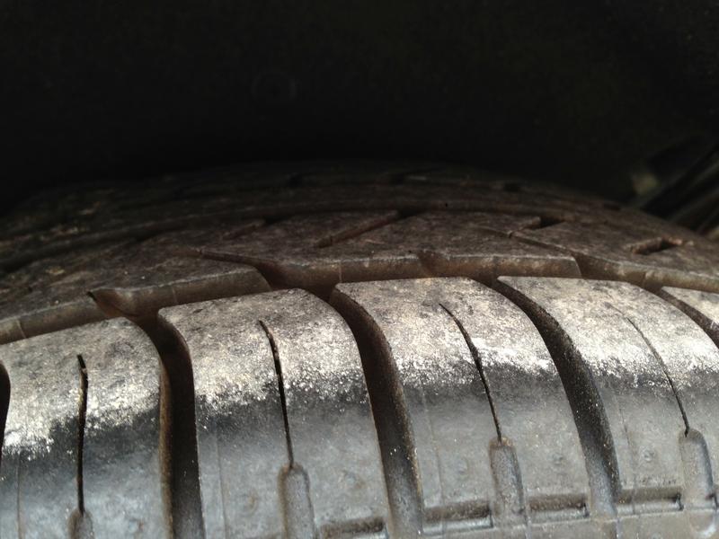

Super excited to join your ranks. Bought My new cooper in Tennesse and drove it back to NY with weekend. Tires looked ok, though showed tread wear. After the long drive I noticed a bubble so I'll have to do something baout the tires sooner than later. Ive been reading about the run flats and w they affect handling, I'm honestly not sure after driving 1000 miles that I'm in love with the handling, but I can't tell if that's from the run flats, the shocks, or that's just a part of the "go cart" effect. When I hit a bump or the depressed pavement on the highway the car is highly reactive. Like i have to hold on for dear life just to remain in a straight line.

Dunlop run flats in front, uneven tread wear/one has a bubble
Pirelli run flats in back.

you may have another issue,
the runflats dont neccisarily ruin the handling, it ruins comfort since theres no flex in the side wall, what will ruin the handling is the tire compound, which you may have tires designed to go long mileage and not have too too much grip. normal all seasons should be the same as a runflat allseason minus the stupidly stiff sidewall.
you may feel like to need to hold it in a straight line on the highway, cause these are light nimble cars and react to changing direction very well (go kart handling)
shocks will only stop you from oscillating (bouncing up and down)
if you never plan on driving in snow, get yourself some sumemr tires, itll be night and day difference. i took off my runflats which still have 70% tread left and put on 30% tread summers.... the difference was noticable in 10 feet

I felt as thought the handling might be in part the gocartyness that I can get used to. I just so I don't have much frame of reference. Forgive me, I am a honda convert
The shocks are probably ok. These cars ride a little harsh, but as you've already said, thats a part of the go kart experience.
I highly recommend getting a set of winter tires for winter and a set of summer for the rest. I will help with each according season by leaps and bounds.

side note: I think my boss has a set of snow tires he'll give me from a mini he sold. I should probably confirm that.
Oh and re: shocks, I noticed on the dirt roads this weekend I heard a little knocking on the bumps :/
I'm also a new owner of an 07 MCS with 55k miles. Your description of the bump compliance of aged shocks matches my experience.
After reading a number of threads it appears that the OE shocks get stiffer as they age. Others have characterized this as a failure mode which seems reasonable.
There have been a number of rave reviews on the Koni FSD shocks and I plan to install those soon.
As for what new tires are appropriate, consult with the Tire Rack and look at the reviews of any tires they recommend before you make a final selection.
If you choose to fore-go the run flats you can carry a bottle of slime and a 12volt compressor. There is a thread on NAM with recommendations for both.
