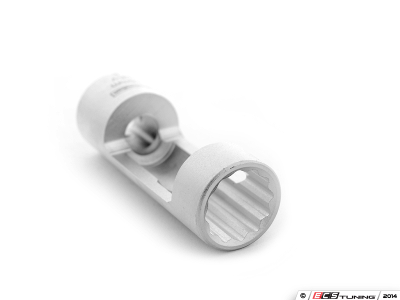

This is the socket I used. Don't let the shaft turn!
ECS Part #: ES#2652174

Please NO ONE SHOULD TAKE THIS ADVICE.
If the nut binds on the shaft, it will spin it, bye bye DDC.
There are tools made for this.
