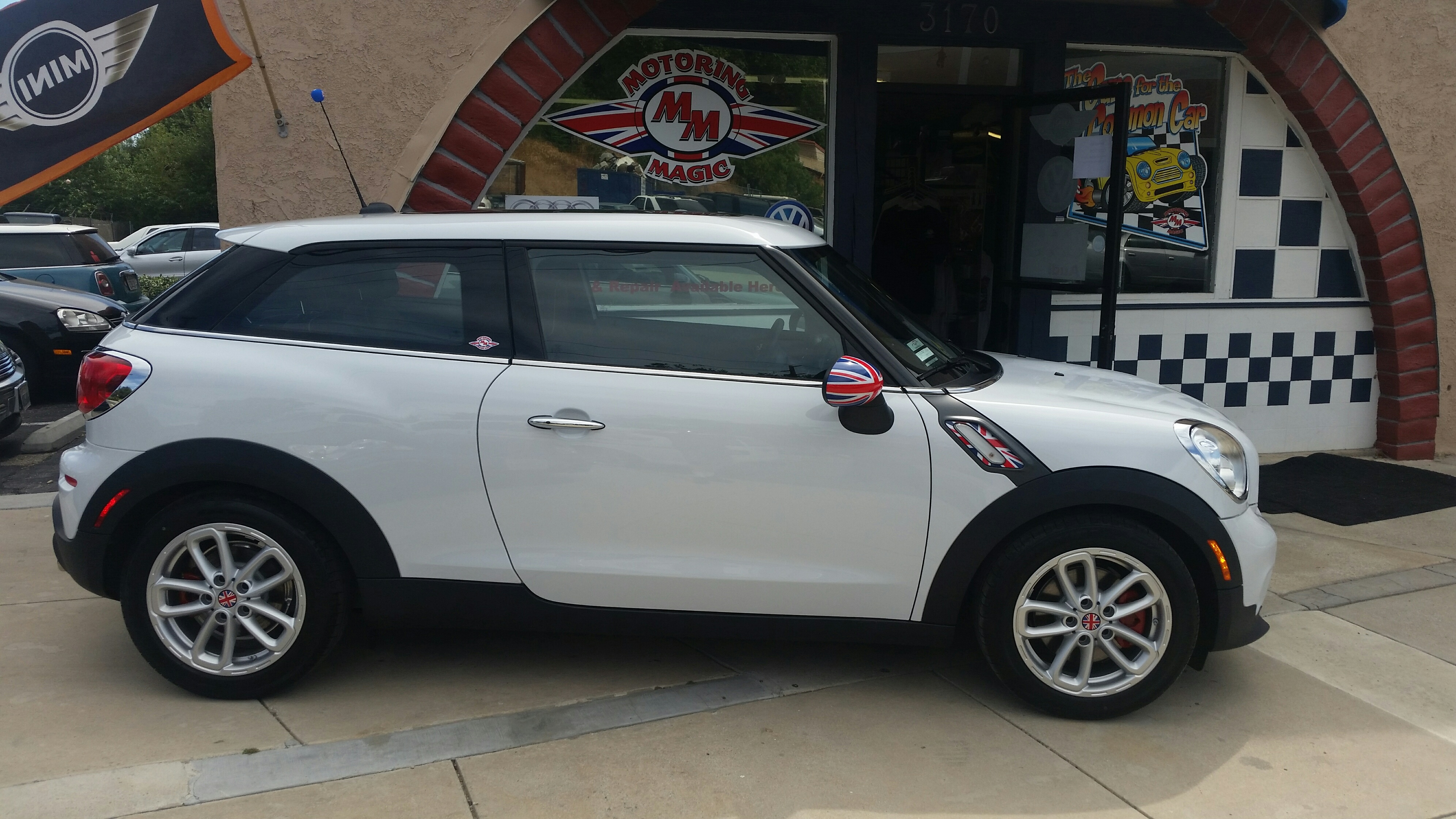

I just bought a new Paceman too!
pm me here to hit me up, maybe I can help......
