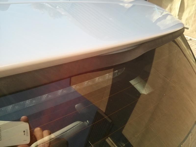

When I bought my car, a section of the rear hatch trim was partially separated. It is driving my nuts and I don't know the best way to repair it. Does this piece press back on somehow, or will I have to re-bond it with an adhesive? Any advice would be appreciated.

Looks like #10 and it has doubled sided tape. You could replace to ensure it does not come off again.
Top Rear Window Cover Trim #10 part # 51317151130

Thank you! I will bookmark these pages so I can search on my own. Placing my order now!
