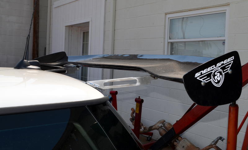

R56 Aero Kit in Development

Interested in more details on the splitter. The attachment for that wing looks kind of marginal...

That is just it. You don't buy this kit for the looks you get it for the function. If they can find a way to support the down force on with that wing with the brackets this would work great!

You need aero on the front and back to provide equal downforce and best handling. The reason for rear downforce on a FWD is because they can still spin out at speed.
At speed the tires are not going spin on the ground they are going to slide sideways because the car wants to go tangent to the turn. By using air to push down on the front and rear of the car the lateral grip is increased and the car can turn at a higher G force load than without aero. If you only had front down force then the back tires would be lighter, not have as much lateral grip causing the tire slip and the car to spin.

Unless one does proper down-force measurement and testing, the wing is unlikely to add any down-force greater than the weight of the wing.
Seeing that it looks more like a sushi table and less like a wing, I would love to hear how the folks building it plan to quantify and optimize its benefits?

We haven't tested the MINI with the wing yet but here's a video of our E36 kit in the wind tunnel. They both use the same wing element but the mounting distance behind the rear wheels is different so final downforce numbers at the tires will vary slightly but this will give you an idea.

The wing starts really working above 40mph. Downforce increases as speed increases. We measured the downforce on our BMW E36, which uses the same wing but with different mounts at about 200lbs of downforce at 100mph. The MINI should see slightly higher numbers, around 225lbs at 100mph.
