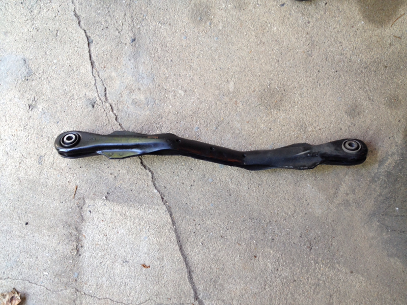

The image of the conte arm is that upper or lower?
Looks a lot like what I did to my upper...from a pothole. Lower would be a lot harder to tweak like that
