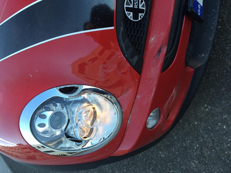

My r53 was backed up onto this morning :(-image-3178436510.jpg
I can't open the hood to assess further ...

did it crack the headlight? if not and it has a scuff it can be polished. the trim ring is like $15. and the squrter cover another $10. I can assure you that the aluminum bumper behind the cover is not damaged. I can tell by your scuff. My damage was alot worse than yours. Your radiator and core support will be fine too. It probably bent the piece on the hood that contacts the latch and it is binding. If all fails take the tire off and the fender liner. then you can remove the headlight from the inside to gain access to the latch. Did the hood come into contact with the cowl? and the fender? is the seam at the back of the hood even? My guess on the parts you need
Hood, Headlight Trim ring, Healight washer cover, Bumper cover, Turn signal, JCW Grill, Paint
You should get it fixed if you can. But if they salvage it anyway. It would be a great deal to buy back and fix. It isn't that bad.
You could fix it yourself and Pocket the difference for your labor. Way cheaper than a new car.
My bet is they will fix it. Body shops have a way of over inflating price on initial quote. they are looking to double their money on parts and labor. Insurance like USAA know this and give them a negotiated price to complete the repair. Get it fixed if you can.
The damage doesn't look bad enough. pull hard on the hood relase it may release. see if you can get it to go. the alignment isn't that far off.

Headlight is cracked and not working. The aluminum beam behind is bent and dented. The hood popped into to fender and cowl as well when it popped up, the seam is uneven and the hood is sitting up and sideways. I could force it open but I am still driving it right now.

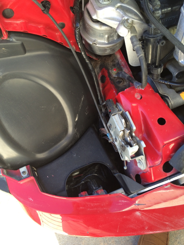

More of an update. I was able to pull open the hood and investigate more. No inner motor, radiator, or beam damage the hood latch and sensor is broken and won't go down. The passenger fender flare is dented and broken clips. Lights still work but are all cracked up.
I guess the mileage is low but it just having in the back of the head it was broken and repaired. And the salvage title is ********. The insurance company determined it was her fault and I can choose to go with her or my insurance. I guess I need the rental so I will go with there's.
My r53 was backed up onto this morning :(-image-1022662981.jpg
The passenger door is now rattling, the hood scoop has broken clips, and something on the inside is leaking I'll show a pic

ER....why stressing over a salvage title....you ONLY get a branded title IF the car is TOTALED....
Yes, the accident will be on car-fax if you have more than $1000 in damage in most states....but as long as you keep the car a few years, and you already HAVE modded it...I would not worry about the value loss...you lost more when you modded it!
As long as the TOP of the motor did not take a hit, and no airbags went off, sounds like some simple bolt on parts, a new hood, some paint, a couple of NEW headlights...you MIGHT come out with a better looking car...no rock chips on the hood!!

If you look at the photo I posted of the engine bay after the hit there is a black substance leaking on the red frame right under that silver looking device anyone know what that is?

Just saw your post about leaking fluid - motor mounts are filled with hydraulic fluid. I know, because I need one replaced. Ouch. That might be what we are seeing here.
