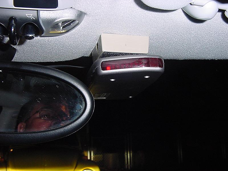

This is an old telephone wall jack fairly close to the color of the grey roof liner. It is held to the roof liner with a roughly 1/16 inch diameter by 1 inch long screw through the plastic part held with a 3/4 inch washer and a wing nut on the top side. Velcro holds the Escort to the plastic block. I hard wired the power line to the Escort as per the instructions elsewhere on the forum. Power goes out within 15 minutes or so of shutting down the car. It powers up as soon as I hit the remote to unlock the doors. The control buttons are easy to reach and it has an unobstructed view to the front.
Attached Thumbnails Electrical :: Radar Detector Hardwiring (12v Line) Above the Rearview Mirror...-escort-mount.jpg
