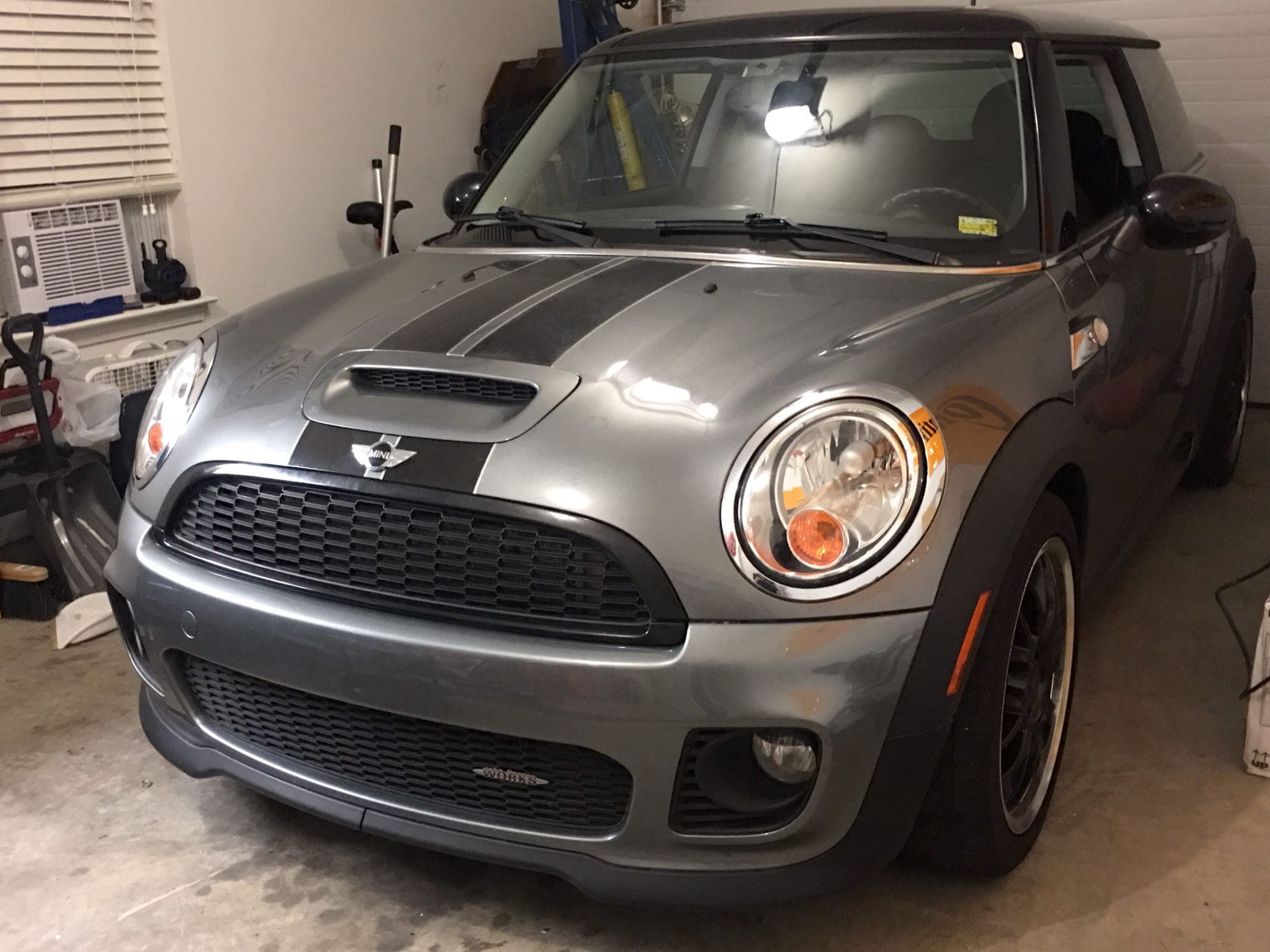

Cosmetically, it's pretty darn good. For an 8, almost 9 year old car, the headlights have no glazing on them and feel as smooth as could be. The paint has hardly any chips in it. I will have the stripes replaced though.
I think the car sat outside for a few weeks or maybe months recently and it's pretty dirty, but after cleaning up just the front end, it looks like it will clean up nicely. Even the interior isn't that bad. The only damage to be spoken for is a cracked windshield which I can have replaced at the dealership I work at for a pretty good price.

Here's some better pics.

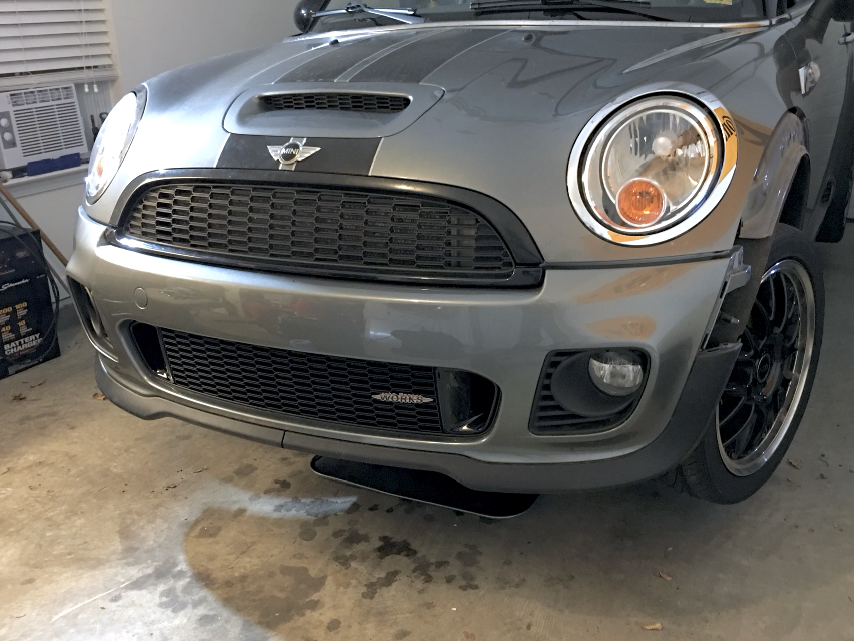

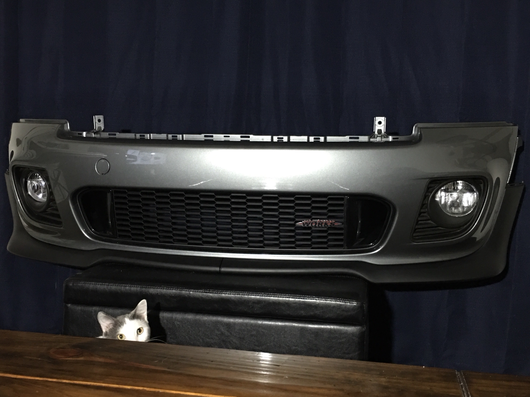

Just got the front bumper cleaned up and put the lip extensions on. Looks absolutely brilliant.
Ressurecting A Legend-photo620.jpg Ressurecting A Legend-photo805.jpg Ressurecting A Legend-photo626.jpg Ressurecting A Legend-photo910.jpg Ressurecting A Legend-photo262.jpg Ressurecting A Legend-photo693.jpg Ressurecting A Legend-photo203.jpg

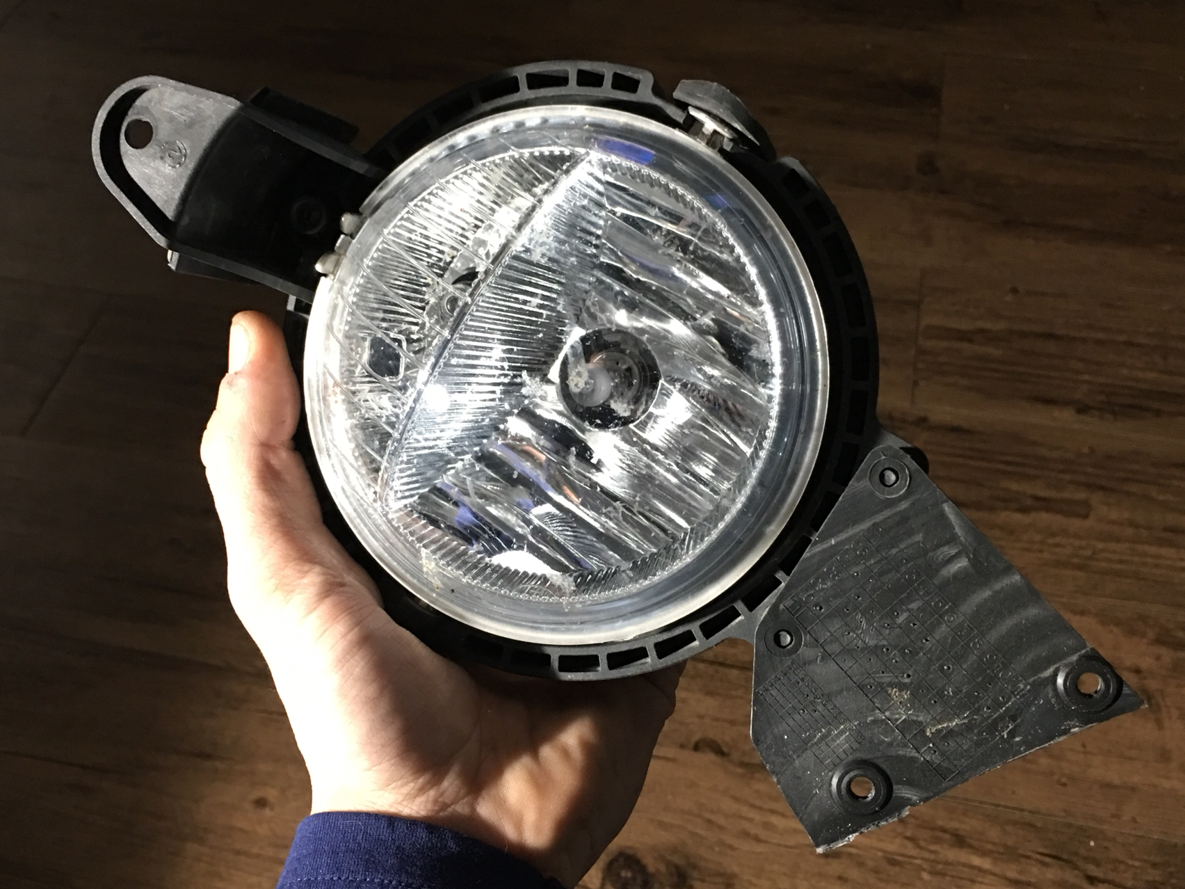

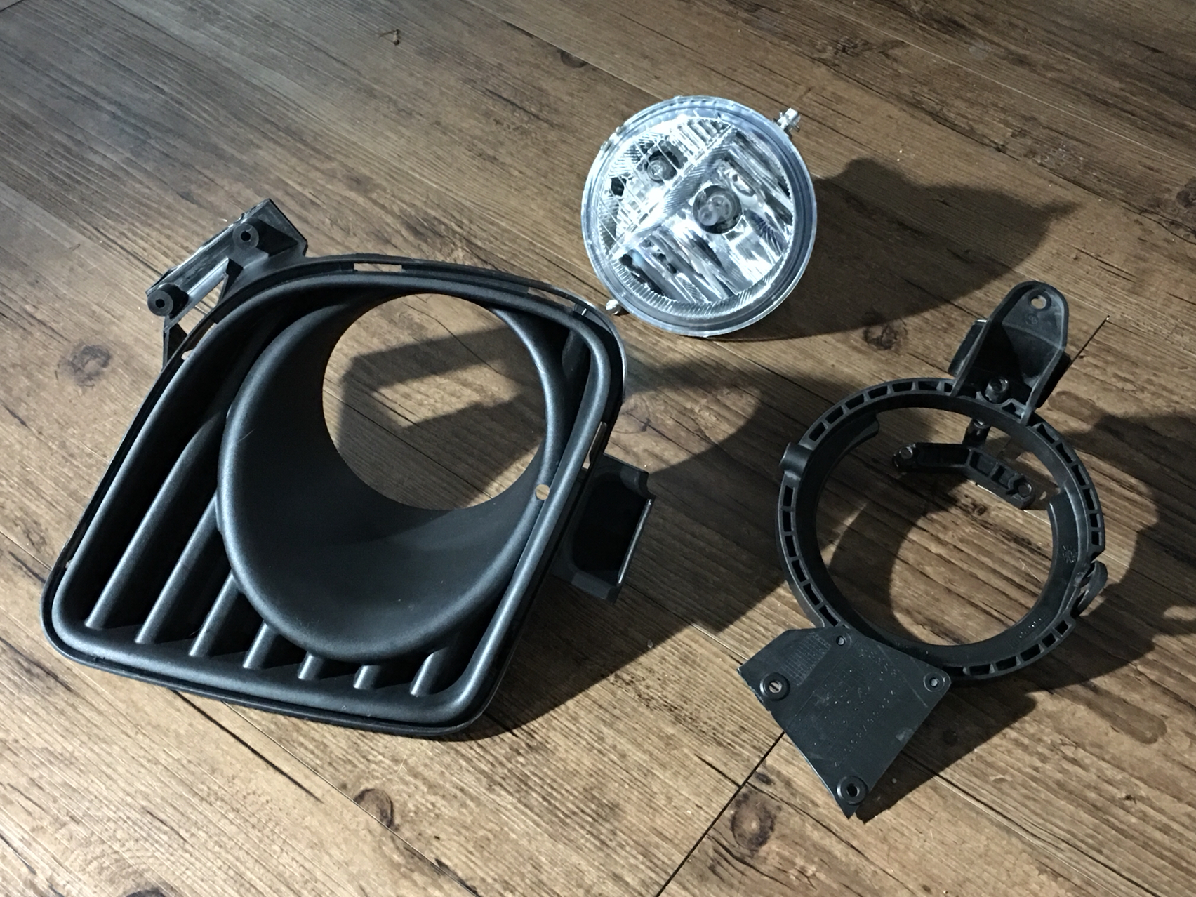

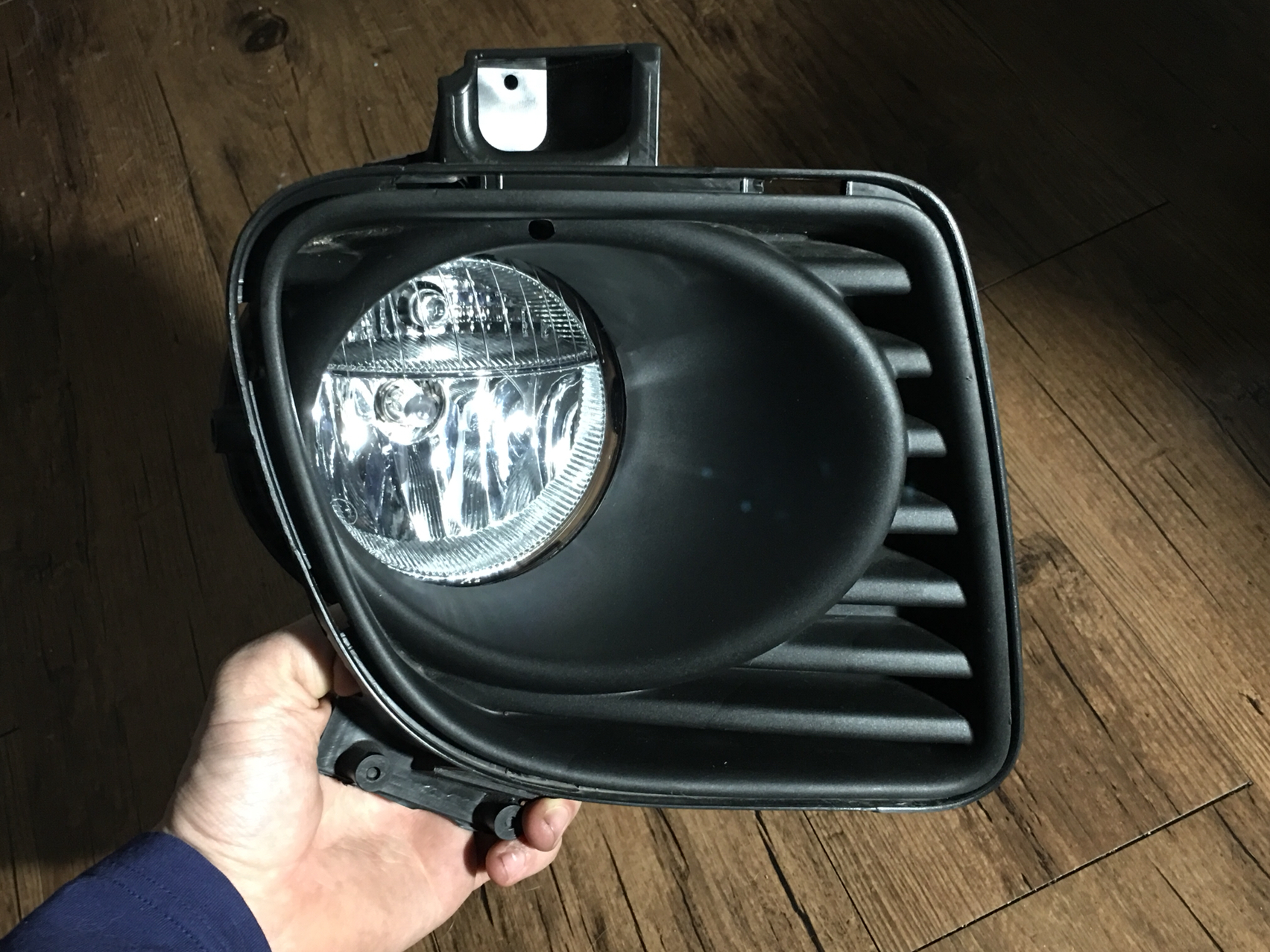

I'm selling the factory set of headlights, fog lights and tail lights up for sale since I'll be upgrading to all LED stuff. If anyone's interested, I think the set is worth about $250. The headlights are close to immaculate, no joke. The surface doesn't even feel like they're a year old. One fog light has the regular wear on the surface from pebbles over the years, but it's not noticeable from even 5 feet away. The other fog is brand new. None of them have any haze; they're clear as day.

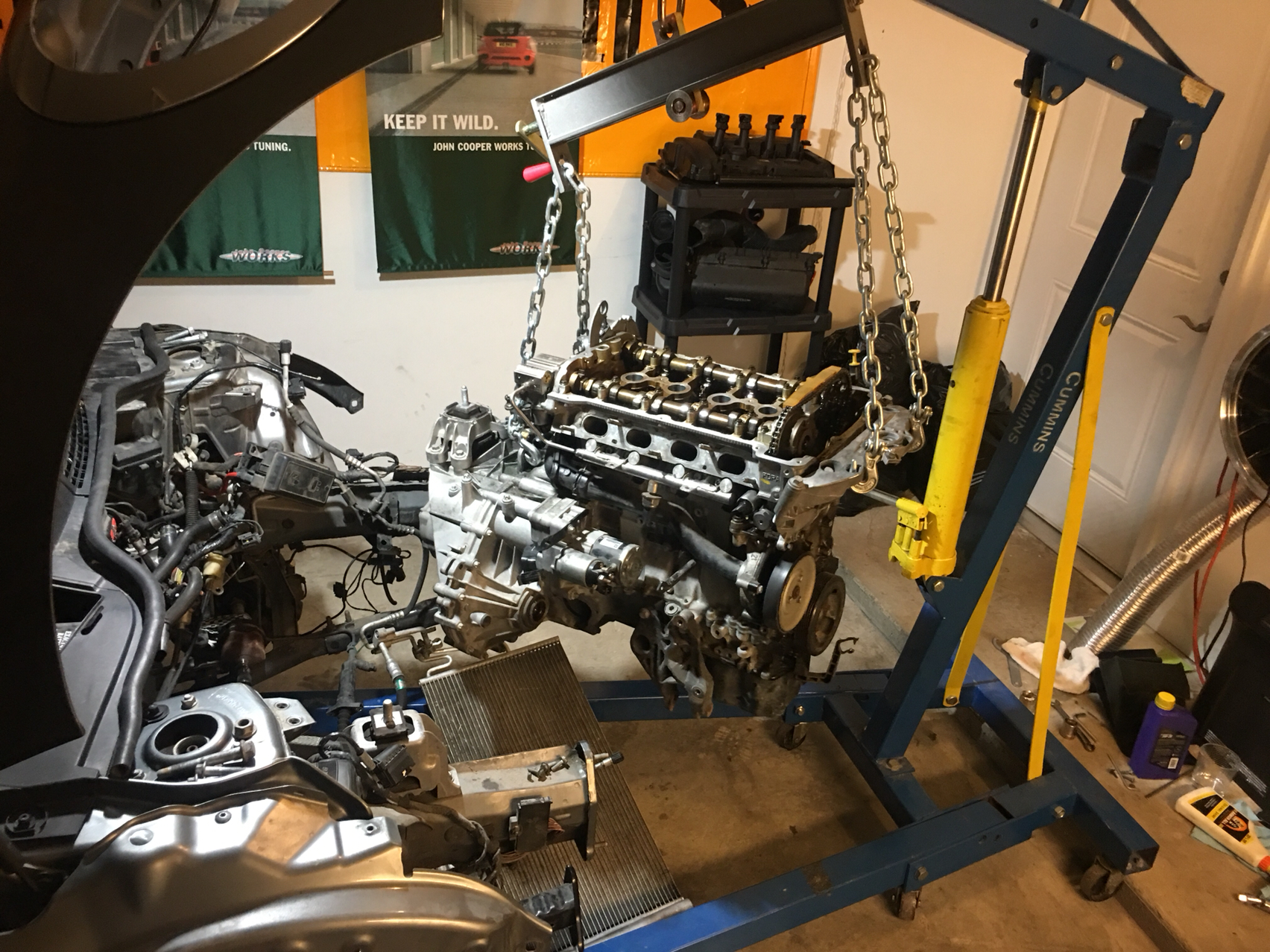

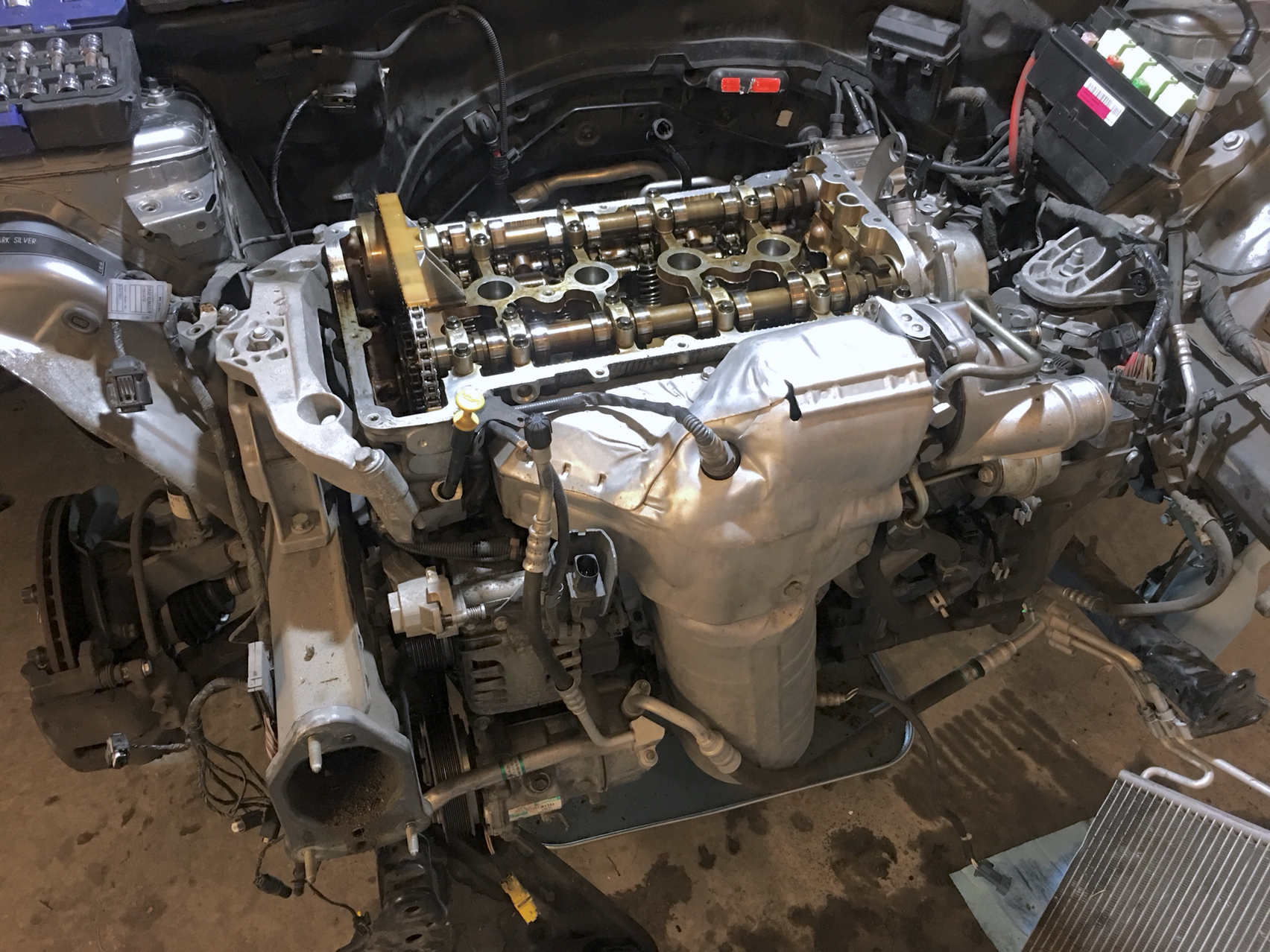

Joy of joys, the motor and trans are out!

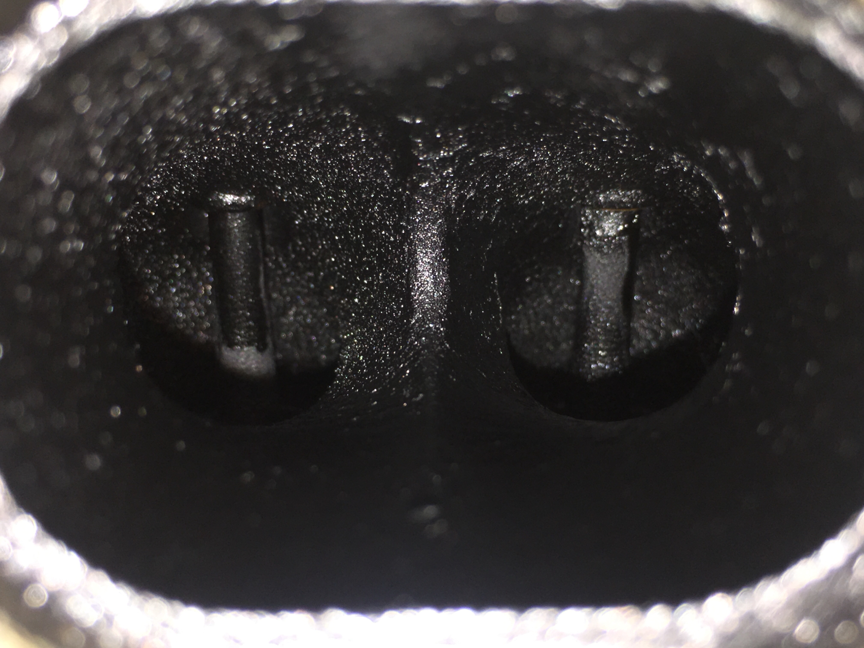

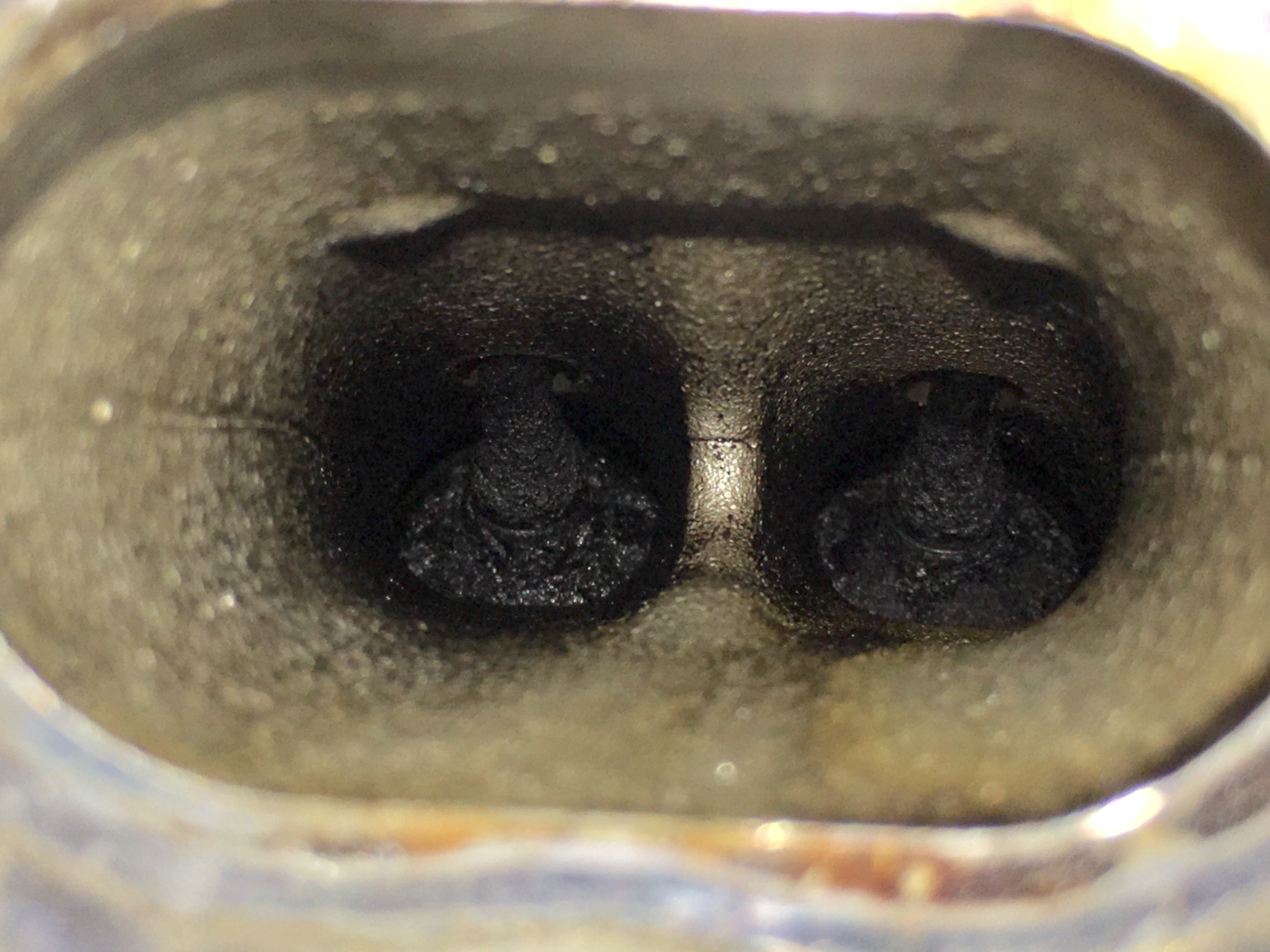

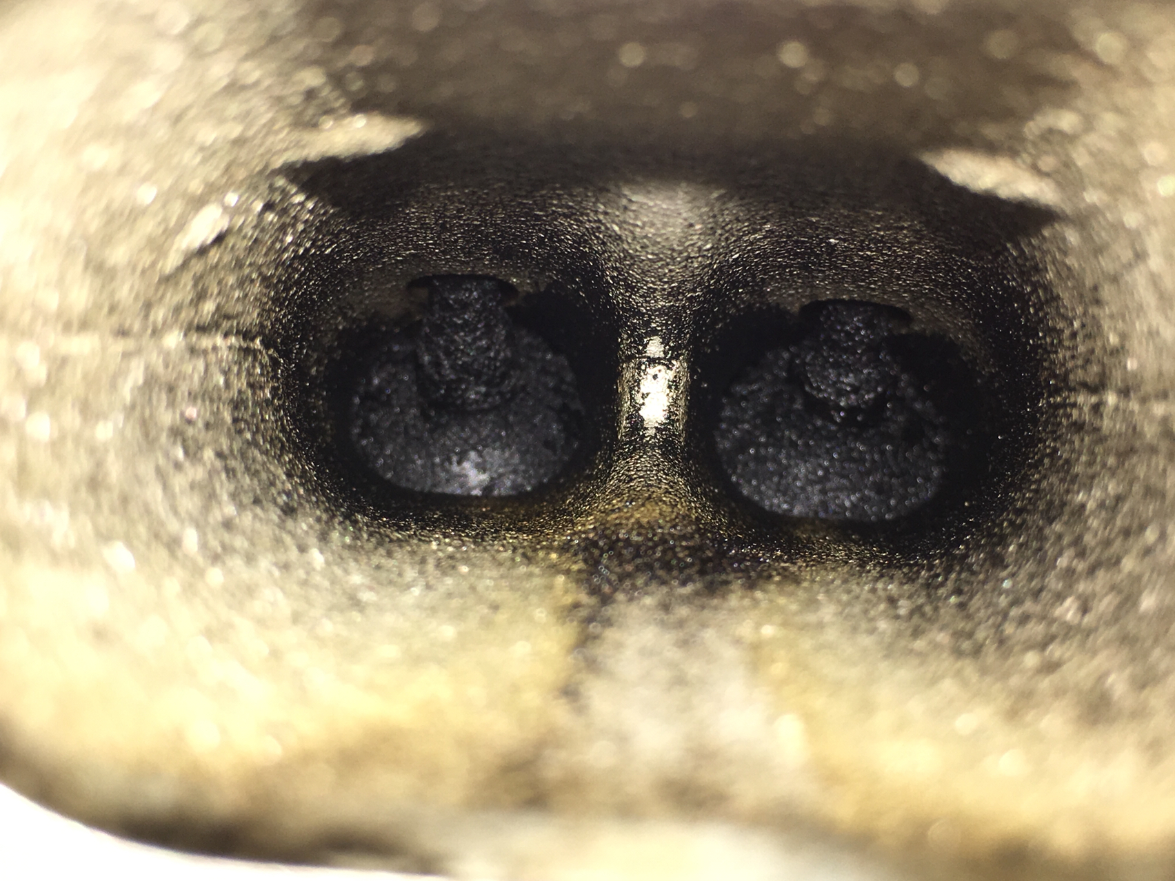

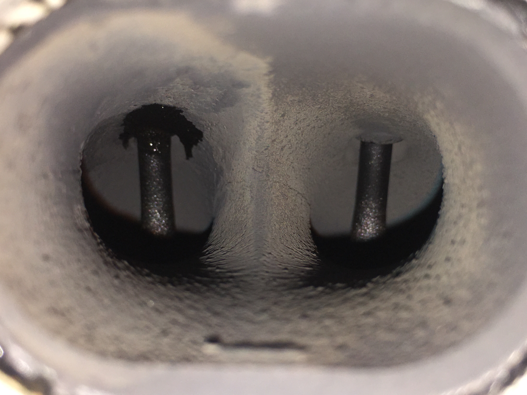

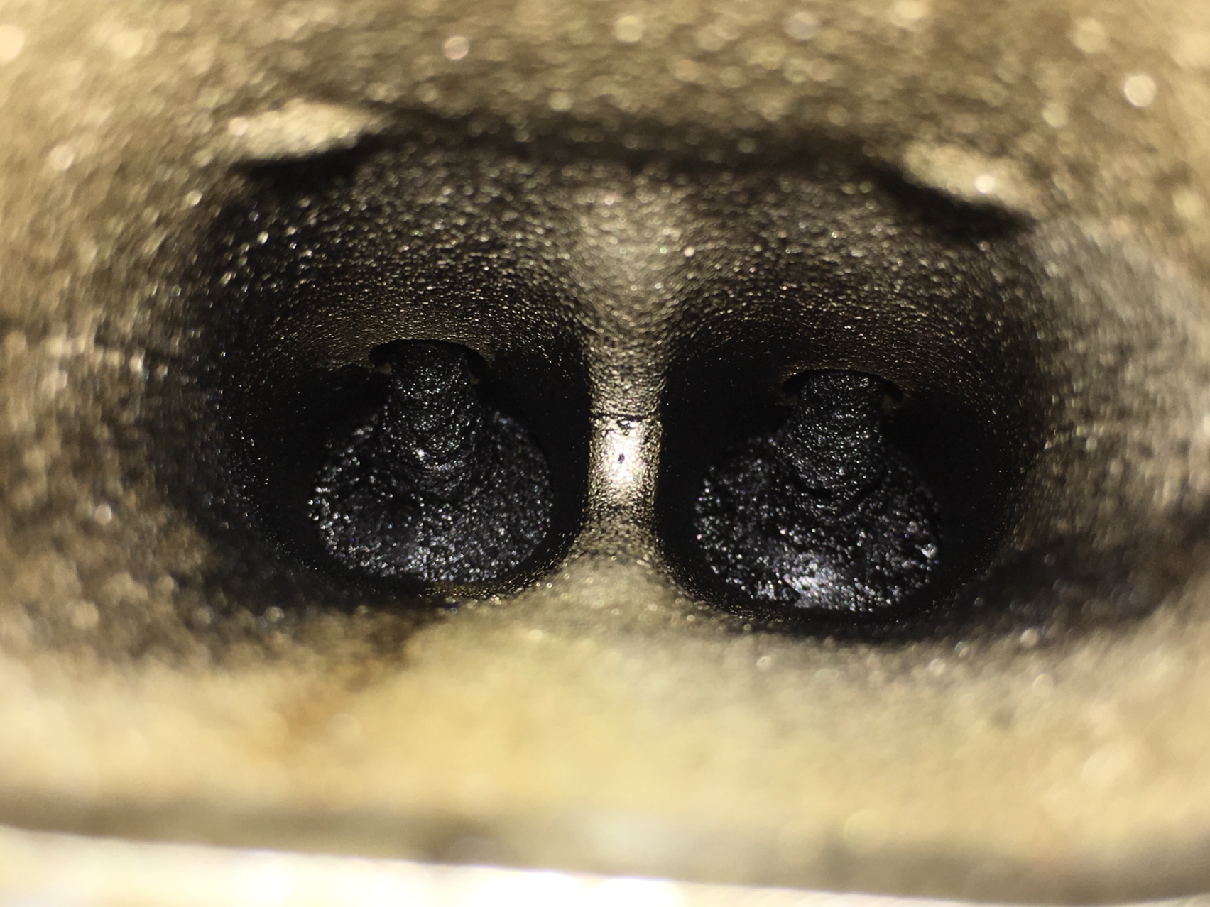

This motor is naaaaasty. Here are some pictures of the intake and exhaust runners, in the order you'd expect.
Ressurecting A Legend-photo318.jpg Ressurecting A Legend-photo978.jpg Ressurecting A Legend-photo299.jpg Ressurecting A Legend-photo555.jpg Ressurecting A Legend-photo630.jpg Ressurecting A Legend-photo961.jpg Ressurecting A Legend-photo78.jpg Ressurecting A Legend-photo601.jpg

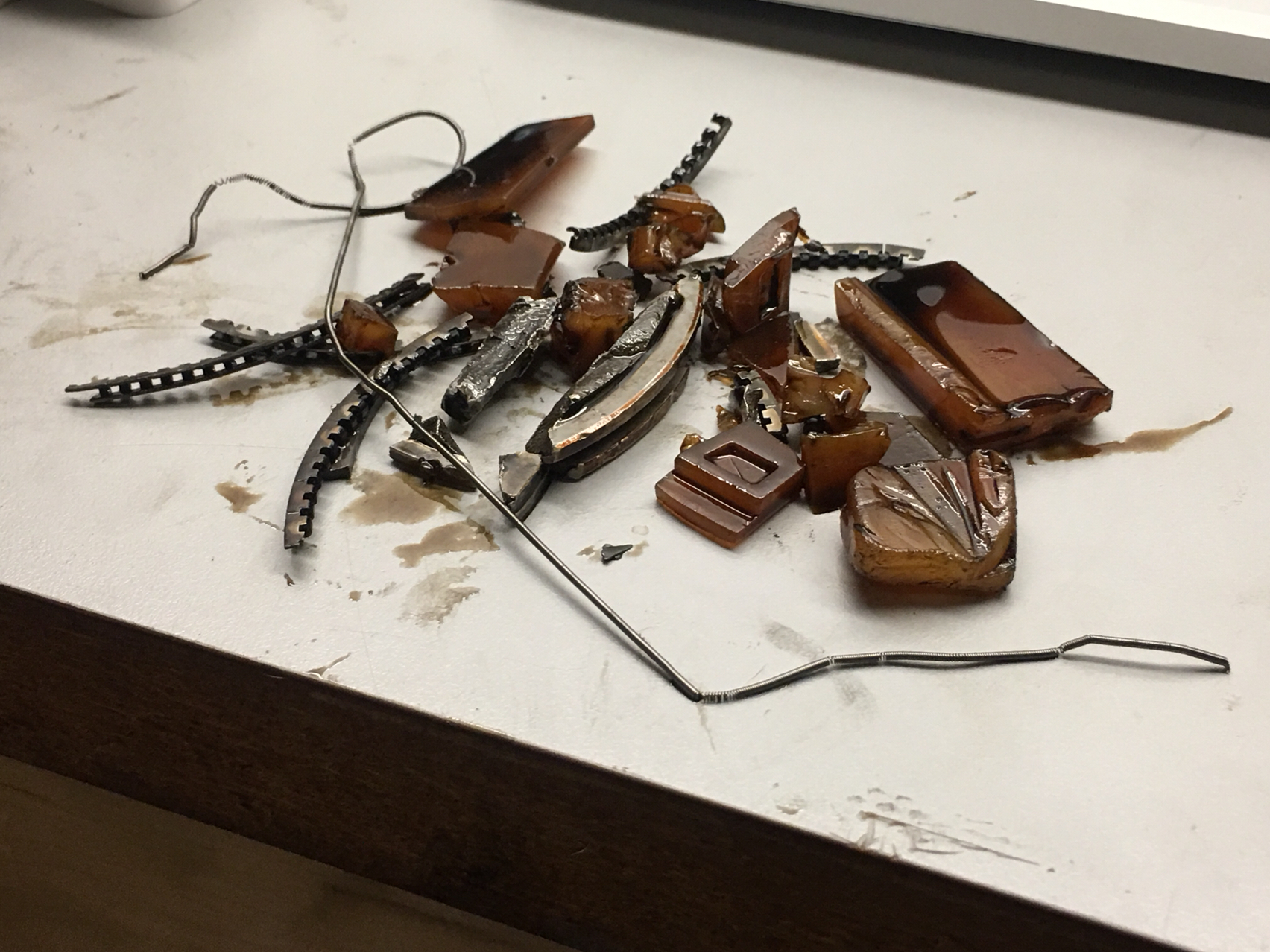

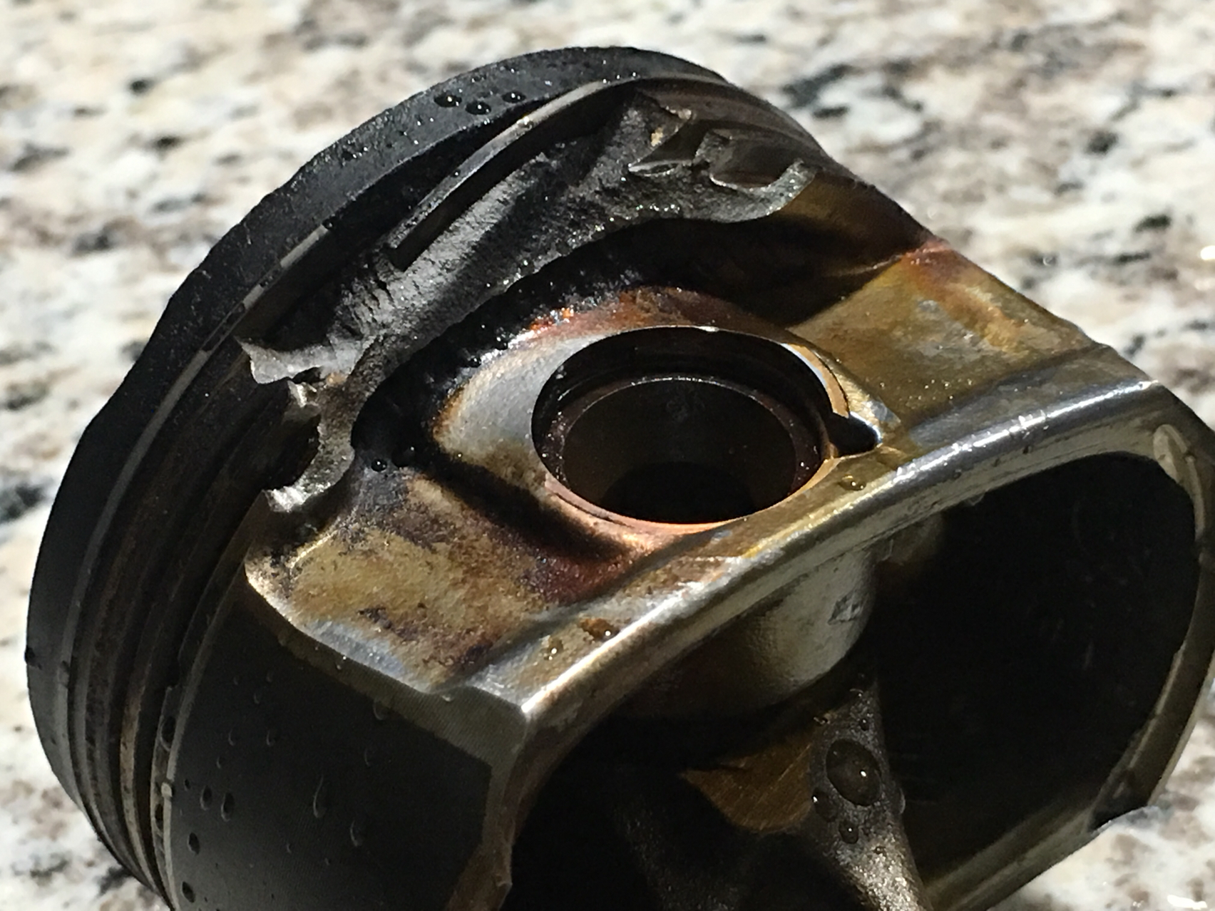

Welp, I've found the problem. Piston #2 us busted. Fortunately, the cylinder walls don't look to be damaged in any way. So, I won't have to re-sleeve the block, but I will have it bored out and use 77.5 mm pistons. Looking for brand recommendations.
