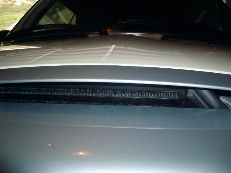

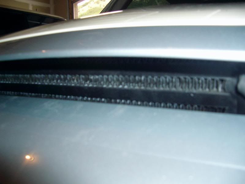

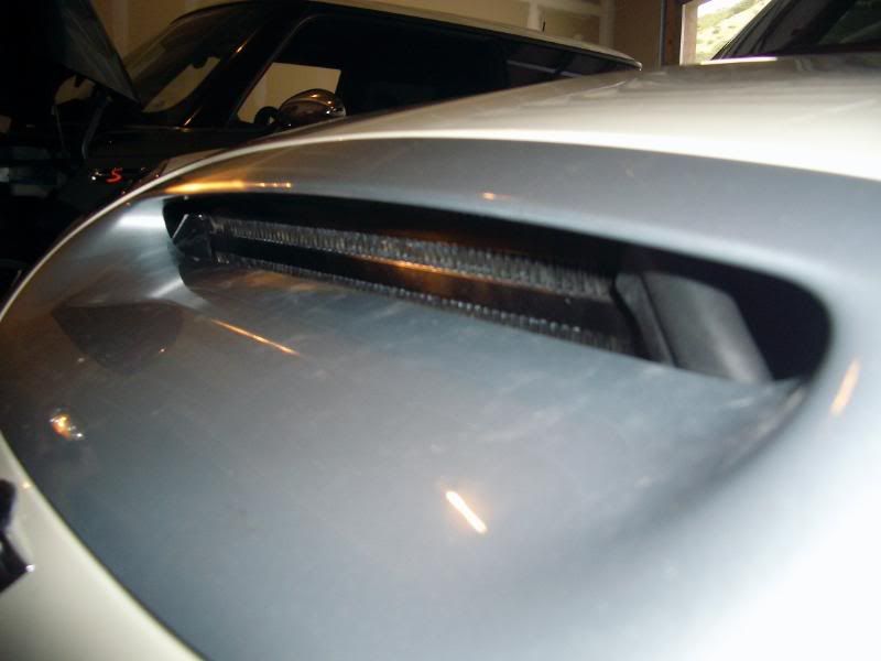

Join Date: Apr 2007
Location: Utah
Posts: 691
Gallery
Quote:
Originally Posted by 483FITTER View Post
any info on how the alta V1 compares?
I didn't have a Alta V1 to test sorry.
Here are the pictures of the Alta fitment I promised. You can see how close it actually sits to the hood scoop. Its my opinion that there is insufficient air flow with the stock scoop, at least from my observations. The Alta was the only one that had a flow issue like this, seemed like most of the air would channel through the first and possibly second set of fins
RMW Head - RMW Shorty Header - RMW Cam - RMW Quiet Catback - 440 injectors - Alta 17% - Alta 22mm Rear Sway - M7 V2 DFIC & Hood Scoop - M7 Coilovers - M7 AE Strut Bar - Voltage CAI - BRISK Racing Plugs - GP LSD - Eibach Control Arms - Custom Graphics - Orciari Cowl Scoops

Old 08-16-2008, 07:19 PM
Longboard Mini Longboard Mini is offline
Join Date: Feb 2006
Location: Rancho Santa Margarita
Posts: 2,438
Gallery
Yep, that's not going to work very well. Why didn't they ever make a scoop to pair with the IC? Maybe it was the whole M7 vs Alta thing.
LB

Gallery
Garage
I can't believe that the Alta horizontal flow IC uses such a poor scoop. If that's stock or similar then you can achieve a 4x frontal area increase with only moderate body work... Of course, you have to make your own scoop.
BTW, while we're talking scoops, I notice that the PU website mentions that their "super PU" scoop increases the volume of air to the IC over OEM by 1.3x. The M7 Ram is 2x for those who want to know.
dr. phil
Reply With Quote
  #116
Old 08-16-2008, 08:50 PM
Partsman Partsman is offline
Legion_of_Doom
Join Date: Mar 2005
Location: Westerly, RI
Posts: 3,989
Gallery
I think Alta provides instructions with their flow-thru to cut/trim the stock scoop.
Reply With Quote
  #117
Old 08-16-2008, 09:12 PM
DrPhilGandini's Avatar
DrPhilGandini DrPhilGandini is offline
My little dose of LITHIUM
Join Date: Jul 2005
Location: Albuquerque New Mexico
Posts: 2,435
Gallery
Garage
Quote:
Yeh...I'm thinking some serious Dremel work. Or a sawzall...
What this suggests to me is that I need to work on my "Bahama scoop" project...
dr. phil
Reply With Quote
  #118
Old 08-16-2008, 09:56 PM
Intense Intense is offline
252whp 200trq RMW style
Join Date: Apr 2007
Location: Utah
Posts: 691
Gallery
Alta actually suggests that people cut their hood scoops for this intercooler to work properly?
I didn't hear that from Alta when I talked to them about buying one last year before I bought my M7. I haven't seen any mention of that from people that sell these things in the marketplace either.... I imagine thats not a huge selling point for this IC
If you check the instructions PDF for the flow-thru(Top Mount Intercooler V.2) on Alta's site it says...
"Taking the time to trim hood scoop will make the install look much more professional."
...but no additional pictures/instructions are given for the hood scoop modification.
Ya, just looked at their site and the instructions.
Trimming it so it looks more "professional" doesn't say enough I think. Professional should be replaced with "functional".
Another interesting thing about the Alta intercoolers I found. They have you grind off the mount points on your Manifold. I always hated that I felt like I had to make permanent modifications to the car for their parts to fit. I felt this way when I installed their V1 top mount.
Seeing instructions saying that you should grind three of the manifold mount points down and "trim" the hood scoop... I dunno. I Like parts that bolt on without making permanent changes to the car. I like having the option to use others or stock parts again if I want to.
Just a personal preference, others might not mind it like I do, but people should be aware of these things.

Quote:
I think a shortfall on the part of Alta is not providing a modified scoop like M7. Here I think M7 thought it out more. It would have been interesting to see how the Alta performed using the M7 scoop. Intense get back out there .
For those that do not know what a Bahama Scoop is here is a pic.
This is a Forge IC that has a) been lifted in the back to allow better air exit and b) as you can see an internal scoop. The scoop tapers towards the back - hopefully "pressurizing" sooner as well as smoother flow thru.
This is an old pic, for I have since fully welded everything up and added a water mister (not a sprayer). It puts out a very fine spray and the intention was to turn it on for auto-X events.
As you can see its made of aluminum so in one sense it should pull heat from the IC itself but on the other it should heat soak as well so I'll leave it to the experts if a different material should be used. Its feed by a M7 DFIC scoop and all hood materials had to be removed.
After 4 different IC's, I've concluded that a) the stocker is a fine piece (i.e. divert yr $ elsewhere) and b) maximize your airflow (i.e. larger scoop and good seals) to get the most out of the IC.
If Intense decides to do more testing, I would gladly send this unit out to him. There is a noticeable intake horn temp difference. Noticeable = the old hand test.
