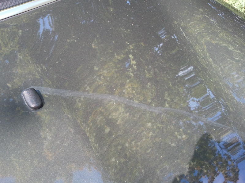

Water Stain on Black Bonnet Stripe - Suggestions to get rid of it?
So I actually picked up the car a month ago with a small water stain on one of the the black bonnet stripes but I have noticed that I have a few more stains and on both stripes now. I'm not sure if it's 100% water or windshield washer fluid but I can't get it off of the vinyl. Does anyone have any suggestions? I tried a very small amount of bug/tar but that just makes it feel "greasy" and doesn't remove anything. Thanks.

Try vinegar and water mixed 50/50. Let is soak in for a minute or so, then wipe it off. Alcohol, same mixture may work also. Or try some Scratch-X

I have the SAME issue. I've been unable to remove the spot by scratching lightly with a fingernail, rubbing out, washing out, even using hydro and slick haven't touched it....worse part is, I have them on the body and bonnet as well! I'm taking the car in this week to get a scratch from delivery handling fixed on the bonnet and i'm going to have them look at it. I have these "spots" in several places on the bonnet, including on the stripes, and also on the door/body panels in multiple locations. It seems to be a paint defect in my case I think. Perhaps there were water spots on it before they clear-coated the care I'm guessing. I'm NOT happy though.
I've attached a link to the other post below. I've received no responses on it as of yet...someone please help if you've seen this or might know what it is....

I have the same thing. The first day i had the car and there was this long drip running down my black bonnet stripe. I went to wipe it off and it was a little oily..turns out...its cosmoline mixed with hot water since the car was sitting outside for hours. The stain never went away. So I took my car to the dealership and they are going to change the stripes tomorrow. HOPEFULLY.

Mine is on the actual paint. Guess I'll be giving the dealer a call tomorrow.

If it's cosmoline, or the washer drip issue, the dealer should fix it and repair any damage under warranty for either cause.

I had that issue at first too. Clay bar fixed it right up

I just got my mini a month ago and noticed spots on the black bonnet stripes last week. I washed it this weekend but the spots are still there, so I came to this forum to find out what to do. I am totally new to car detailing, and have never even heard of claying before. Can someone tell me where to get this clay and recommend what kind??

Claying is a process that removes surface contaminants. You can pick it up and Walmart or Checkers/Autozone etc. I have used Meguiars and Clay Magic and like the Clay Magic the best. Picked up a kit at Autozone for $7.99.
Here is a link to the autogeek video for claying:
http://www.youtube.com/watch?v=ZcZRj...eature=related

You can find either Meguiars' or Mother's clay at most autoparts stores and walmart.
If it comes in a kit all you need else is a nice towel. If not, you will want to get some Quick Detailer type spray for lube and a nice towel (preferrably microfiber towels).
Wash these towels separately from other cotton towels/cloths.

no mixture of home chemicals worked for me, neither did clay. Prima Finish got 98% of it off. Just need to make sure I wax it a few times, and use more hydro?
