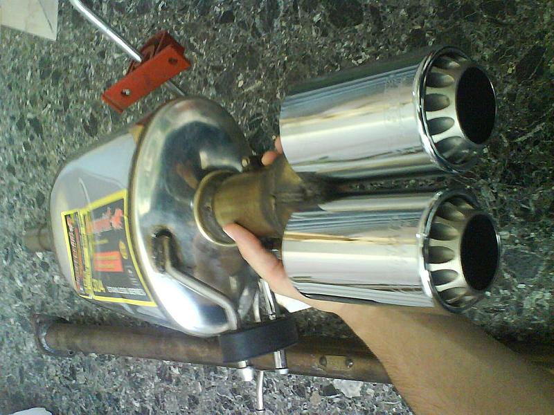

The exhaust is here.... Tomorrow morning will be on the car.

The sound is just incredible!!!! And , i tested it already, the car not just feels but actually IS a bit faster!!
